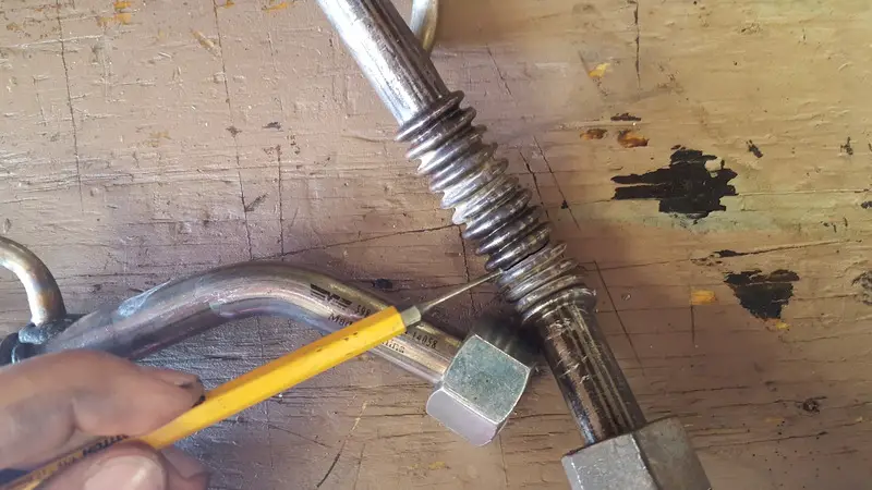

myself and many others have the passenger side tic tic tic as we accelerate. So I began to investigate whether or not it was my exhaust manifold or EGR tube. Both EGR tube and manifold are notoriously known for leaking on our explorers. I was about to just order the passenger side manifold but one last check with a mirror and I found it was only the EGR tube. Here's a picture of how I found it and where the crack was. (notice my square mirror under the EGR)
I got a mirror and looked around the EGR and what do you know there's the culprit. More than likely that's the culprit for many of us yet we don't look underneath to notice the crack.

Also here's another picture of the bad EGR and the crack exposed even more.
