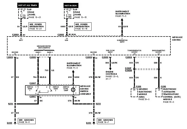

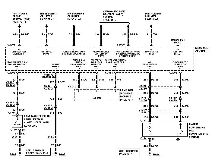

I'm not really sure about it, but taking a look at wiring diagram I can't see why not. Maybe just check pin 32 for ENGINE SELECT (V6 OPEN / V8 GROUND).
