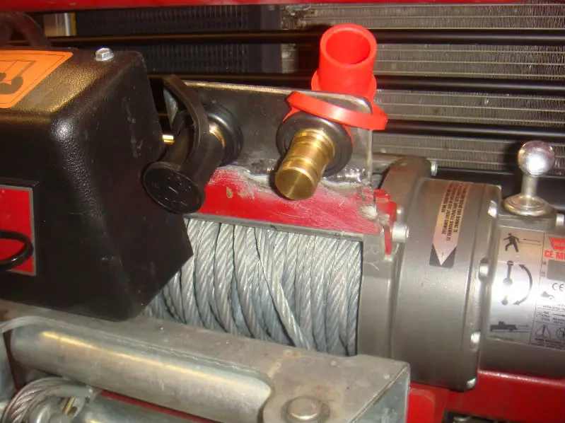

I saw a magazine article that showed someone doing some emergency welding using their 12v battery as a welder. I'm wondering has anyone here done this and just what do you need as far as stinger end and ground?
If I remember they used a set of jumper cables which I carry. Then all I would have to do is throw some welding rods in the truck.
I'm in the process of installing a remote 12V set of terminals and just thought that it may be worth the while to rig up something. Unless it's just a waste of time as far as the welding part is concerned.
I would think that if it did work that it would just be for tacking something like a tail pipe hanger :rolleyes:
