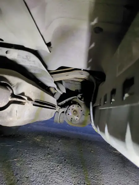

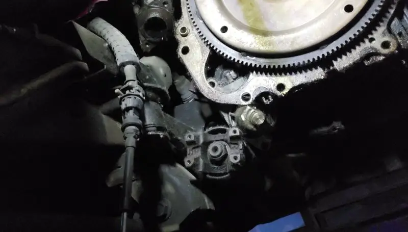

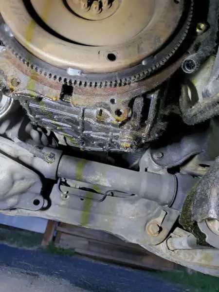

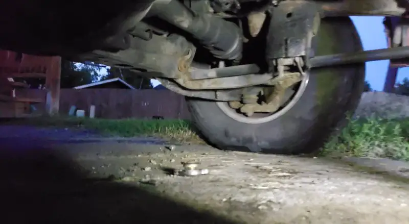

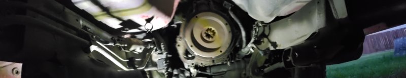

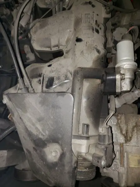

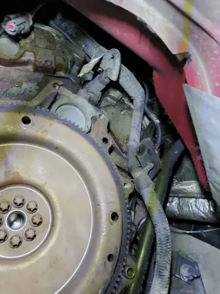

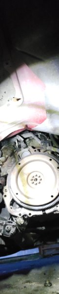

Underneath Red(99).
Left side to right front
under Red front closer
Left
Closer
And that's all for front left
Right/up (these are all of Red) LB (96)coming tonight or tomorrow morning.)
Moven down
And done for the Right.
One more underneath of back nothing in between.
Rear under
Sorry guess more total

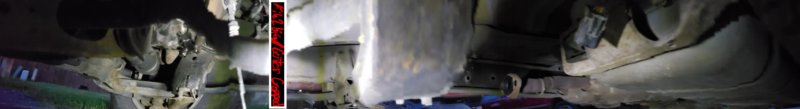

Last underneath this one is a panoramic from left to right you'll need to zoom in and I would start looking from right to left. Can you guys even download these?(note in there.)
Something got screwed up but they are all there. . Be back ran out of time

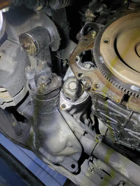

That 99 looks clean. You're almost better off finding a V8 junker and swapping that into it. Pretty much a bolt in swap. It was be easier to V8 swap that truck with the proper donor truck than it would be to swap all the v6 stuff from that 96 into it.
But it's a V6 too? It's 5he same truck really XLT just younger.
AND THANK YOU FOR THE COMPLIMENT!!!
agreed with koda2000, converting a 99 auto to a manual transmission is not something you can do in that short amount of time and given your abilities. It is rather involved process to get a 5 speed in the 99 truck, you do not even have the parts you need like the 8 bolt flywheel for the 99 engine to convert from flexplate to flywheel.
I'm sorry but that is an un realistic goal!!
Now to remove the entire drivetrain from the 96 and install into the 99, that is a bit more realistic, but it is also very involved. The entire wiring harness & computer, exhaust system, fuel system, pedal assemblies, everything must be changed over. The 96 truck uses a return style fuel system, the 99 is returnless. The more you think about it, there is just no way you can pull this off in a week let alone 2 days and 2 nights! Sorry to break it to you this way but I am guessing this is why you came here to get this answer.

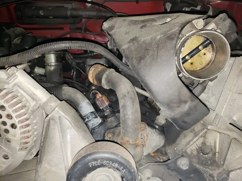

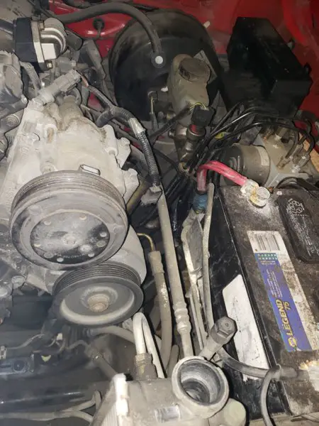

But here is the rest of Red(99). Under the hood.

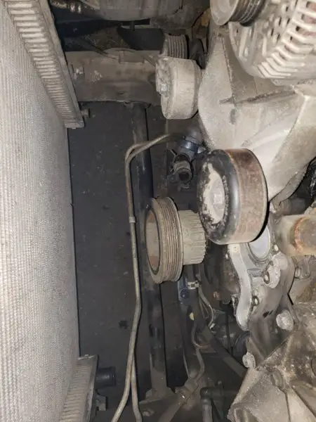

And moving forward towards the left
With...

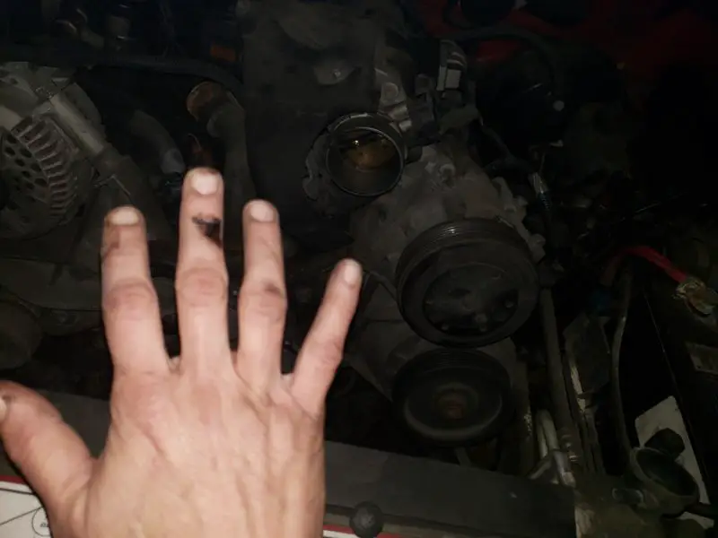

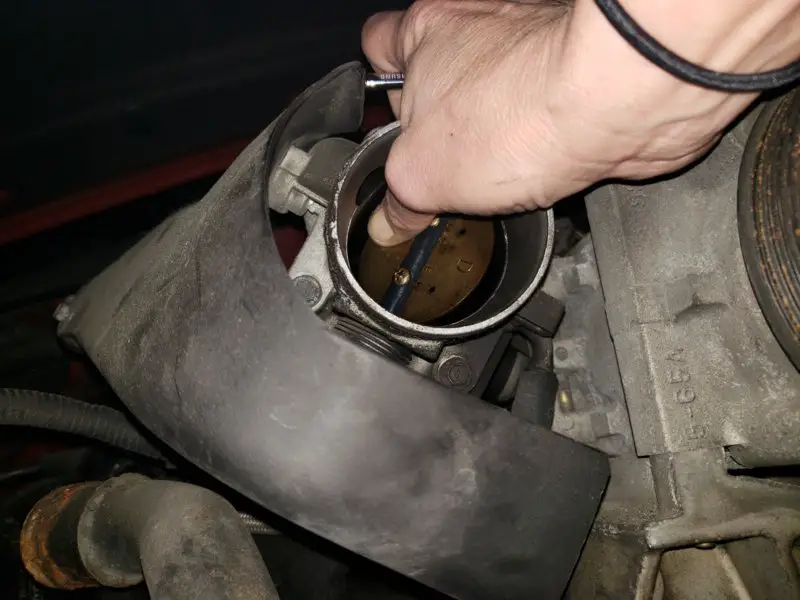

And then getting to the money shot ;).... Almost...

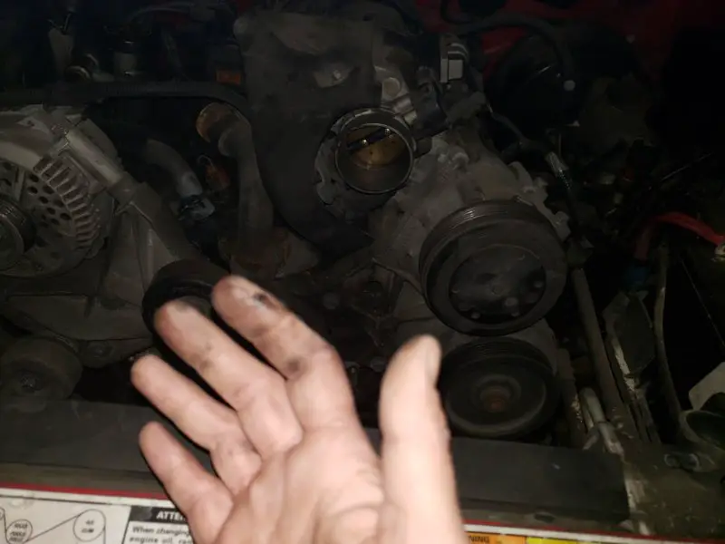

And the part with the oil...
:confused:
Right in there....
Pulls out.....
o_O:thumbsup:
And (it was kind of hard to get my finger far enough holding a phone but)...

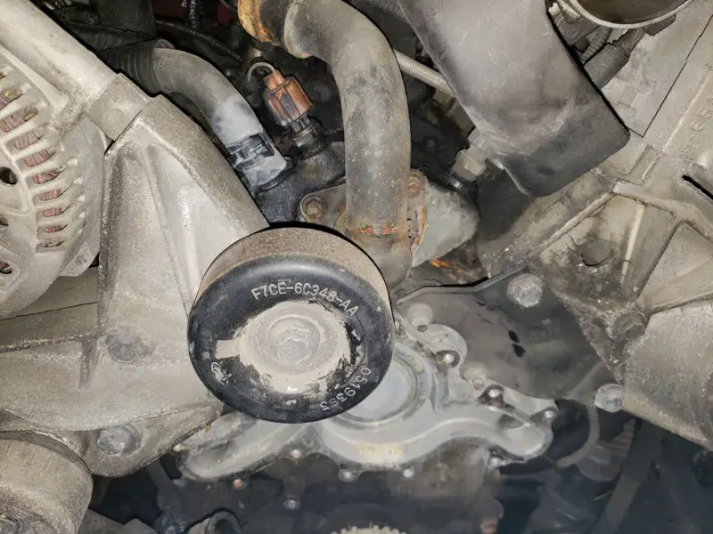

K now some "Cat" who helped me change out my water pump first put HIS in her and he had a nice amount on his finger. HE ALSO was the one that said it was blown.... Thinking now he may have been talking out his pooter.

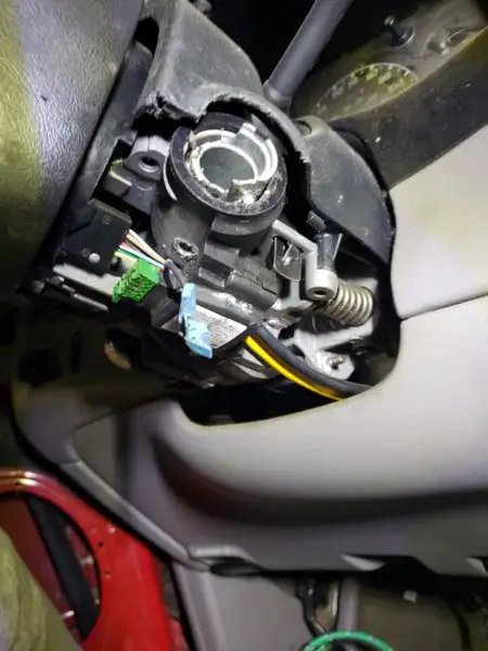

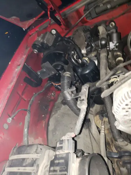

K last but not least I have the ignition to deal with also....

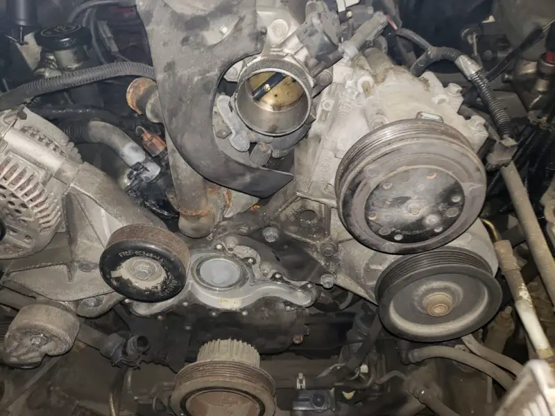

Oh one more left side of engine..

How do I figure out what may be wrong with this engine? Any way at all?
And can I rebuild my Transfer case? Should I just get one from the junk yard? OR just put the broke one in and drive in 2 wheel drive..?

To put the 96 drivetrain into the 99 truck is not just a simple engine and trans change over
You have to swap the fuel lines and the fuel tank too (99 has one fuel line, 96 has two)
You have to swap the pedal assemblies to go from 99 auto to 96 clutch
You have to swap the entire wiring harness, not just the drivetrain harness but the under hood power wiring as well because the 99 also uses a different power distribution box and components
The 99 uses a different instrument cluster (digital signals) and some of the wires moved locations, so you have to swap those and change the wiring around
That is just off the top of my head without being there, this is a major project, It would be easier to swap the 99 body onto the 96 frame and use the 99 springs to fix the lean
