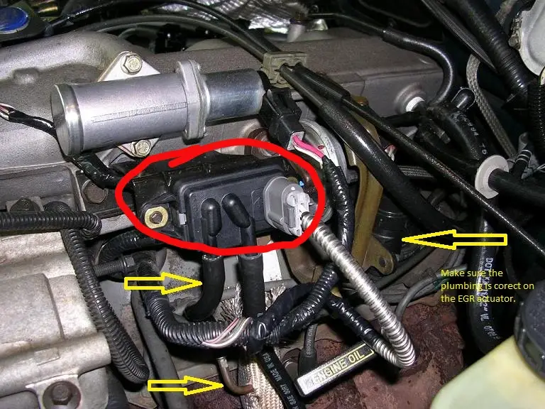

Ok it's the DPFE.
Seen this before on my own rig. The CEL coming on at highway speed and then back off is the clue.
The other unrelated codes are caused buy the DPFE fail with the EGR wide open. Does all sorts of crazy stuff depending on if it failed due to corrosion, open or short circuit etc.
Mine fails regularly due to ethanol gas producing tons of water out the exhaust. The CEL on and off while driving is the DPFE every time on my truck.
Part number is EGR 151
It's this dude right here.

The truck in the pic has been modified to use the late model DPFE so that's an option as well. Haven't done it to mine yet, I just carry a spare.
Had to change it this weekend on my trip up to Flagstaff in the rain and snow. Seems to be a guaranteed fail when climbing to high altitude on my rig.
Got about an ounce of water out if it.
The DPFE I pulled is new so after drying and an alcohol rinse it'll be reusable.
