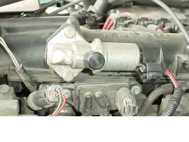

Idle Valve
Remove the black cap off your Idle valve, the black knob, careful not to break it. There are small filters inside the cap, they may be clogged and causing your problem.
Hello.. I have cleaned this filter... i have cleaned the MAF.. and the engine always fails...
I think I have solved the problem. I again go over and clean the air circuit INTAKE.... and I put a new spark plug (denso iridium power) and engine works much better.
