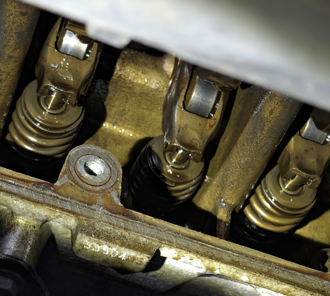

Decided to try and narrow down the noise. Definitely coming from the driver's side. Hard to say if it was top or bottom but decided to pull the valve cover (broke the very back of it off 😞) and found one of the springs completely compressed, all of the others seem to be at about the same height. How many should be compressed at the same time?
You can run it with the cover off. First feel the rollers to see if any play.
