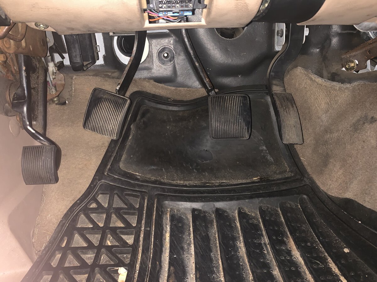

It’s doing the same thing with the clutch in or out so that makes me think Neutral safety switch?
also my pedal looks weird

Could be a bad clutch safety switch. Could also be a bad ignition switch, but that hasn't been messed with.

It was the clutch switch. I took it off and bent the pedal closer to the break which gave it more travel. hooked the switch back on and it fired right up! Took it around the block once or twice.
Need to put the hood on and probably top off fluids but we in business baby!

and yes your clutch pedal looks funky funky!!

Yesss it was hard to bend idk how it looked originally.
I was going to leave the OG master cylinder on there for the initial start up but the connector to the slave was different than the LUK one I got. The LUK master has a slightly smaller diameter pedal arm I noticed when the clutch switch has some play that it does not have on the OG arm. I think maybe just messin with it got it seated better or something.
