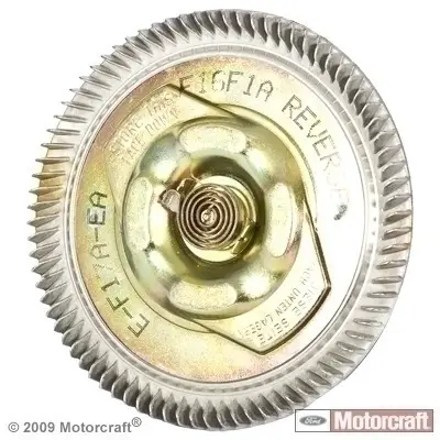

It's pretty easy to tell a standard duty fan clutch from a heavy duty or severe duty fan clutch.
A standard duty fan clutch is thinner and barely has any fins, like this:
A heavy duty fan clutch is thicker and has lots of fins, like this:
A severe duty fan clutch looks like a heavy duty fan clutch, but just engages even more.
