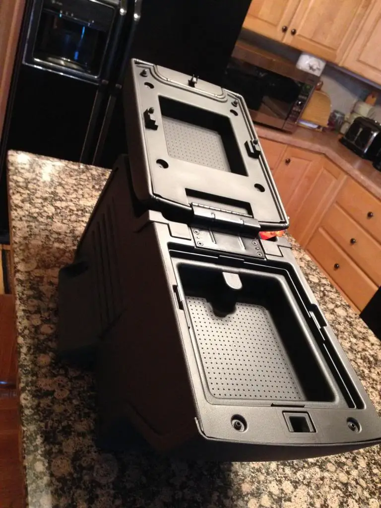

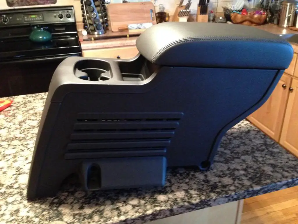

Intereseted in seeing a picture of the console. The instruction picture doesnt look like the picture on their website. The website looks to have the more updated lid that is thinner, the instructions looks like the taurus X console.
I order mine when I bought the truck and dealer went half on it. They want to charge me 2.0 hour install .I did myself but I do paint n body for a living. Not very hard just take the cover off in the rear, use the hole to line it up and tighten the bolts and get a punch for the front two put something's with color to leave a mark then cut the carpet. You should see the hole. Hope this help
Received the console, looks just like the factory ones. Installing tonight when the wife gets home.
