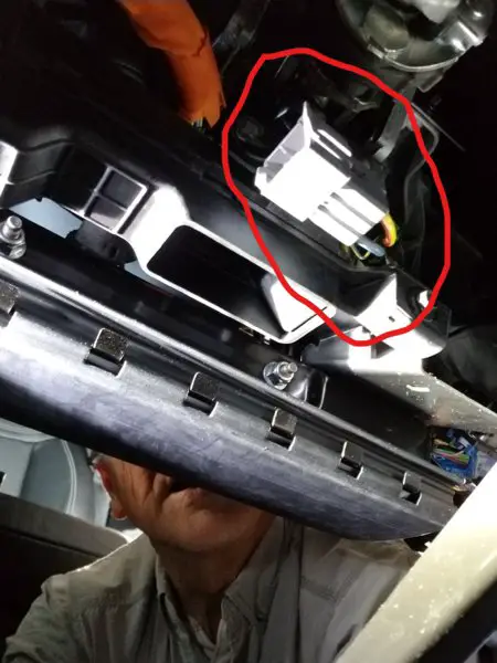

mehardy
October 12, 2019
6
6
Dauphin Island, AL
2020 Ford Explorer ST
I found the plug on my 2020 ST. Remove the lower dash panel. The plug is under the steering column area attached to beam behind and above the lower air bag. I can send pictures if needed.

mehardy
October 12, 2019
6
6
Dauphin Island, AL
This the connector for the brake controller on a 2020 Explorer ST. I just finished my install and it works!.

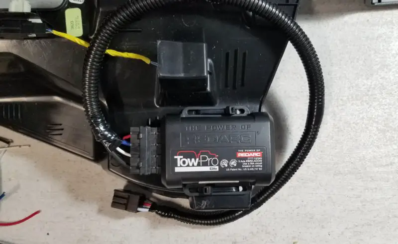

mehardy
October 12, 2019
6
6
Dauphin Island, AL
The brake controller connector is below the steering column behind and above the air bag. My chin is only for reference in the attached photo! I installed the
Redarc Tow-Pro Elite Trailer Brake Controller. The control unit is hidden away and the control knob is easy to mount.

Sean Bice
November 2, 2019
7
4
2020 Explorer ST
Which of their harnesses did you use to plug into the factory Ford plug? They have 2 different ones listed for Ford/Lincoln. TPH-005 and TPH-007.
And where exactly did you mount the box? Can't tell what that piece its attached to is.
