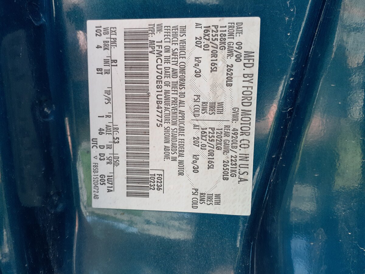

My axle is a code 46, or 3.73 open diff.

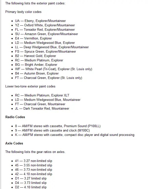

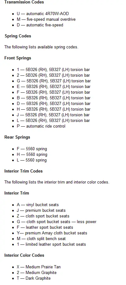

If I am not mistaken, axle codes are about the differential, not suspension. D3 seems to be 3.54 ratio, limited slip.
There are spring codes and axle codes.

may help

The D3 isn’t his axle code.
Sorry, me bad - confused the spring code with axle code. Out of curiosity, looked at the spring codes on my '98 and it's 2H. This vehicle has the somewhat rare four-wheel ARC (air shocks) and as far as I understand, in this setup the rear springs are supposed to be wimpy. Is that what H stands for?

Okay so my Front Bars are a D, but what does the 3 mean then it doesn't match anything on the list posted? Or am I reading my door sticker wrong?

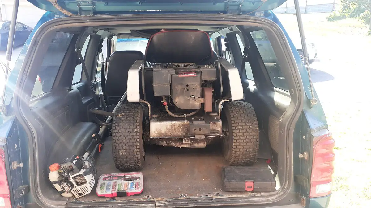

It has been done, I got the Monroe coil over shocks and put them on over a month ago. Over all, they are great and picked up the rear end about 2-2.5 inches. The leafs are no longer rest on the overload spring, and the ride is still very rough. But it's just barely rougher than before I put on the coil overs. The truck definitely takes a load much better now, and I've put it's capacity to the test while moving. I was also surprised how well it carried my riding mower, and I was surprised it even fit in the back of my 2DR. The next parts on the list are going to be rear sway bar and front sway bar.
