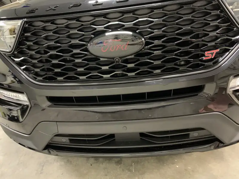

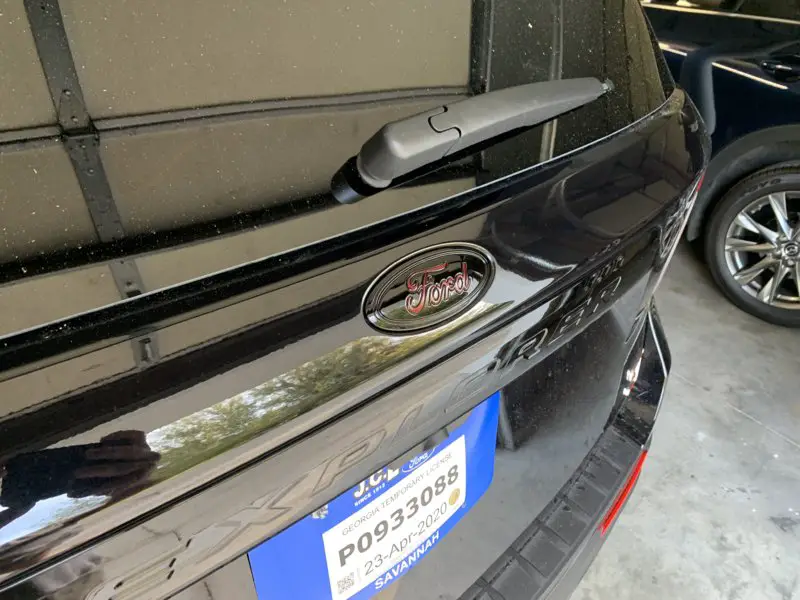

I just finished the rear one now for the front one! I used the guy on eBay. They turned out perfect.
Just finished the front grill! Love it! Thank you to my awesome wife! Her poor wrists. My 6’4” frame hands would not fit behind there.

They look great!!! So for the front....I see your wife wrists wow!!! How did she get it done ?? From the top or bottom? How is the logo connected in the back? By Clip or nut? Like you I am 6'5" and 260...my arms are not getting in there unless the whole grill comes off...Thanks
MrHyde
March 18, 2020
16
14
Richmond Hill, Ga
2020, Explorer ST
From the larger grill slats on the bottom. They are a 10mm but on both sides of the emblem. I recommend using a mirror to orient yourself with the nut and use a socket wrench. It doesn’t take much to get them on and off just frustrating and painful. But worth it. I looked at taking off the whole thing and it requires removal of the whole front bumper.

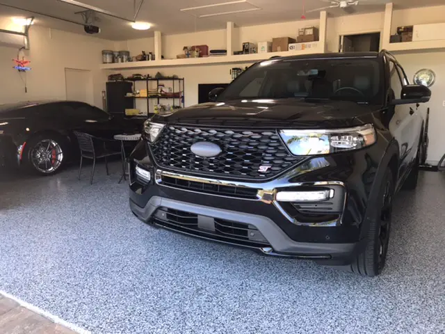

I know some of you saw this pic I posted months ago. I love the black and red ones that you’ve installed but if your lazy like me these carbon fiber look overlays really are holding up well. I power wash my florida bugs off all the time and they are absolutely on forever.

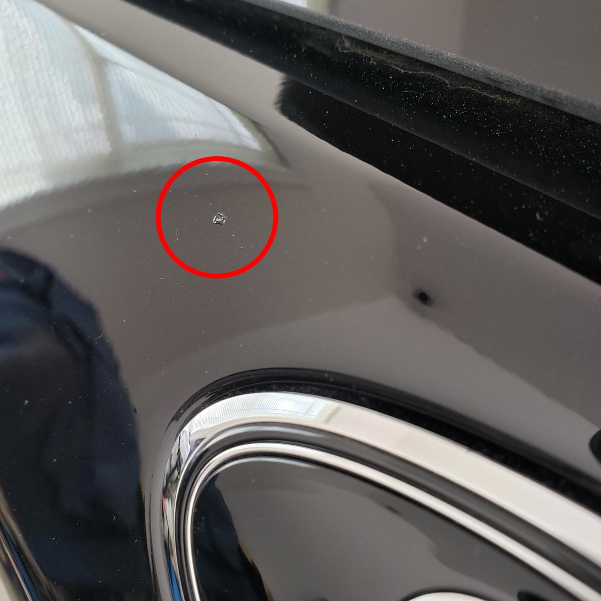

Just got mine on this weekend. As Mr.Hyde said it isn't easy on the wrists reaching up in there but I wasn't about to start ripping off the front bumper cover just yet. I used my kids baseball arm sock which helped a little.
Also bumped the rear hatch with my ring and chipped it. Seems the paint is awfully thin idk.....
