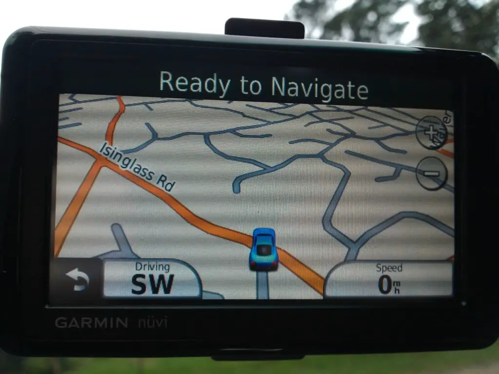

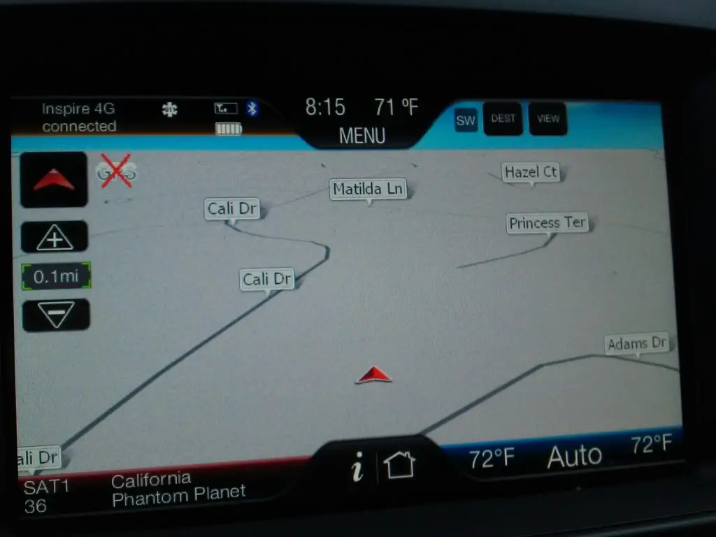

This is my Explorers GPS screen.
And the Garmin I bought.
Somehow, the $160 garmin knows where I am, and can get a signal(full signal, actually), while the $900 Ford system has no idea where I am. It's weird cause some days it works fine, other days it's completely lost.
