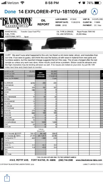

So, I have changed the PTU fluid in my 2014 Sport at 45k, 75k, 95k and 113k, roughly. Every time, but one (as well as the factory fill) has been with Royal Purple fluid. The attached results are disturbing, to say the least. I tested it at 95k and all was fine. Obviously, this has me concerned.

It's amazing to see the difference in the report from 90k to 113k. 113k is in this thread. 90K is in this link. PTU Change Experience
I am shocked to see that much difference in 23k...

Maybe at has had the failure where the gear walks and now it or bearing is rubbing against aluminum case creating all the aluminum in the oil?? Do you hear anything different? Any more gear whine then before??

That's a good thought. I will have to pay more attention to it, but I don't recall hearing anything different. Good thought!

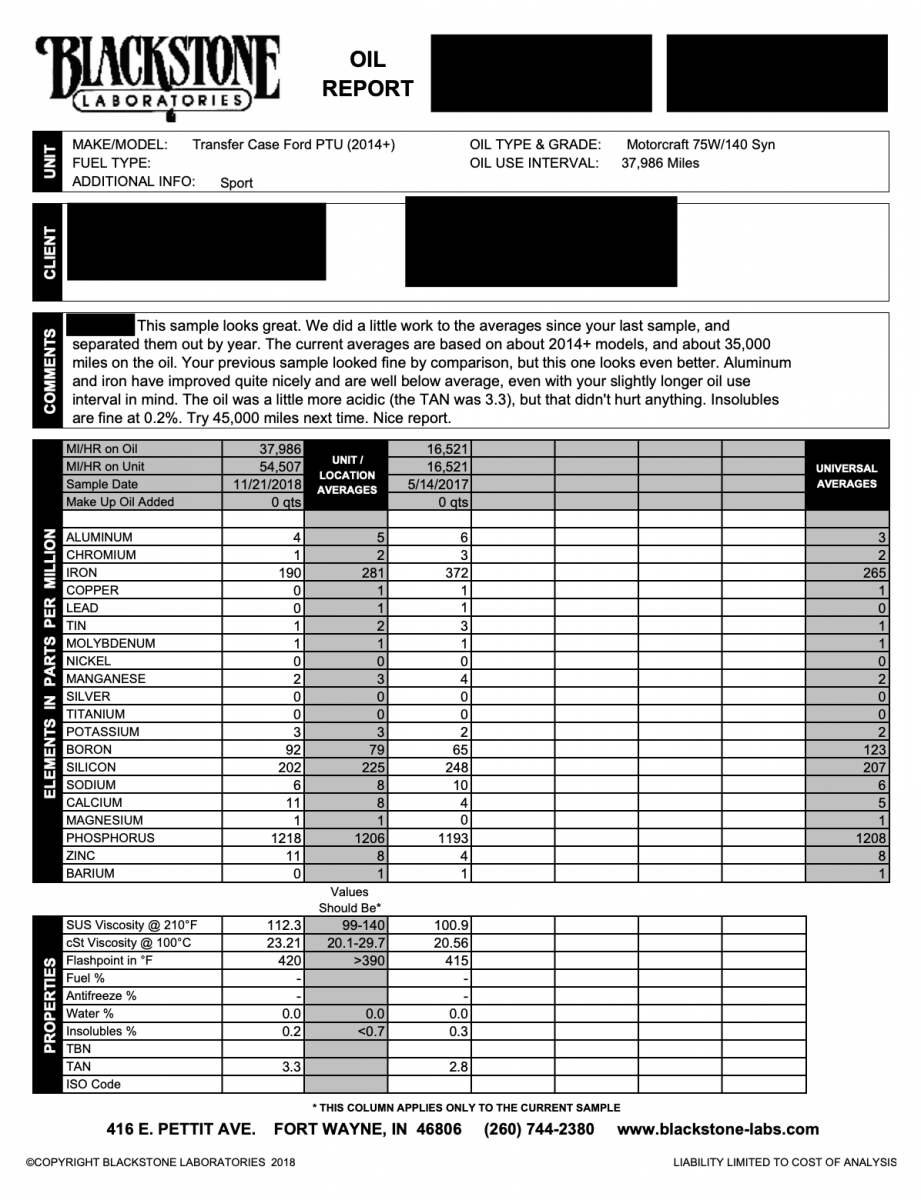

Just following up on this. This is my result (attached PDF - Register for access) with a 38,000 mile change interval including my previous change report. I'd say it still looks incredibly important to change the PTU at least every 45,000 miles. I stand by the importance to do a change very early to get all of the metals out of the oil. Motorcraft PTU fluid appears to be working very well and I see no reason to change to another fluid whatsoever. Thread on what metals look like in the fluid after just 16,000 miles here..

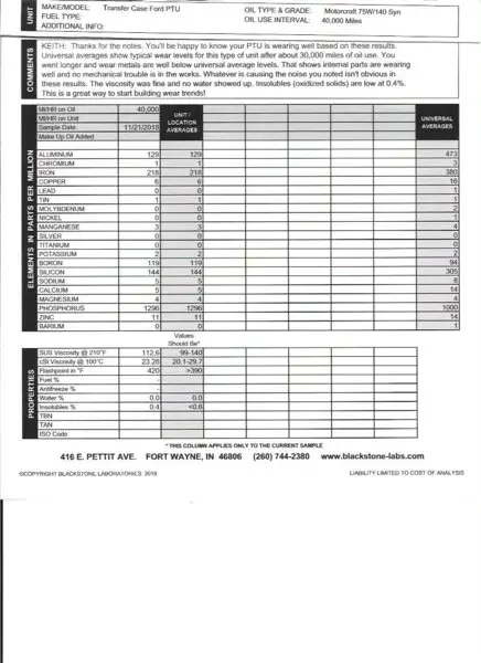

Blackstone results are attached. I have a 2011, and just changed the oil at 100k The results represent the motorcraft gear oil 75w/140 from 60k to 100k. I changed the oil a few years ago with 60k on it and just did it now with 100k on it. Its just another data point for those curious on how long they can run the oil in their ptu. I had just change tires also and heard some whining noise. Thought it was ptu. The noise has subsided as tires wear in.

Thanks a bunch for sharing it’s great to have real data points. Wishing you the best this holiday season.
