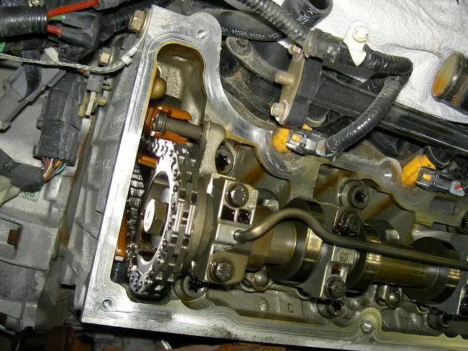

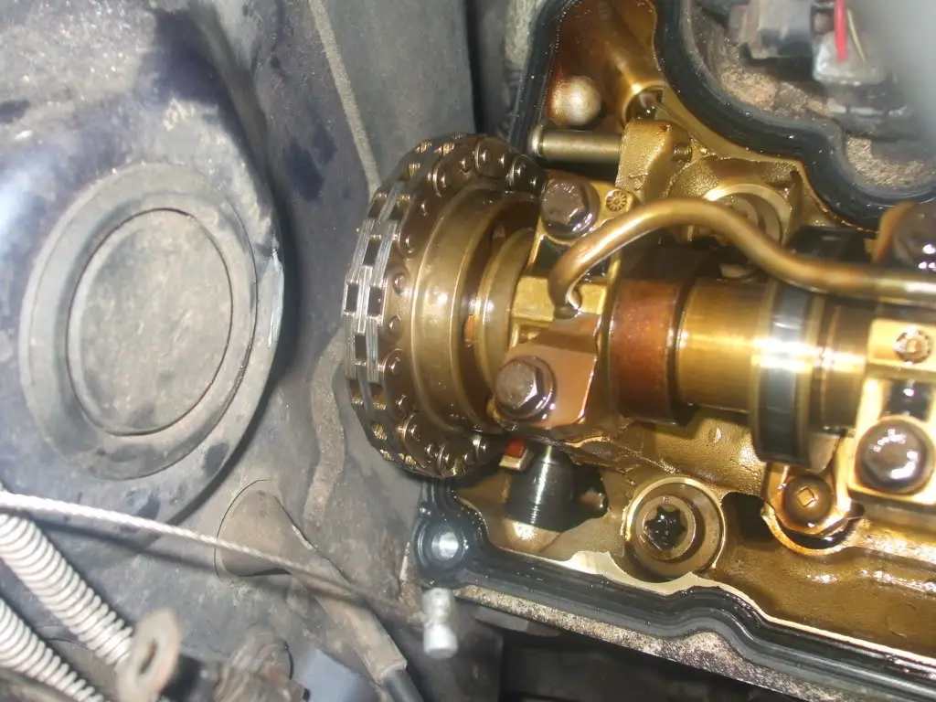

Been trying to figure this out for a few weeks now, being busy with a baby and all is kind of hard to get this done, pulled the valve covers to check the timing chains. They Seem Ok, One Chain in the rear has a small amount of slack on one side, the other (the side with the tensioner) will not budge but in honesty it seems to jump a tooth it would've been unlikely. It was making a tapping noise before it shut off almost like a knock. Truck turns over and cranks sometimes starts but only for a brief moment like .5 seconds.... it does the same thing with ether.

Was the rear chain grinding away at the bolt that is supposed to hold the top of the rear cassette? If the tensioner is in place there should be no play on either chain.
Did the rear look like the first or second picture?
it still had the guides in place actually like the first picture I'm hoping it didn't jump a tooth, the front one was tight on both sides. the rear was loose just on that side where your guide is missing in the second photo
there were no grind marks or nothing, no broken plastic etc.. I can pull the valve cover tonight when I get home. Ford did a great job engineering this one to be serviced by their techs.
Funny the chain has play. I wonder if your tensioner is stuck in. Easy way to tell if it jumped a tooth would be to set #1 to tdc and check and see that the notches in the cam are directly parallel to the head.
