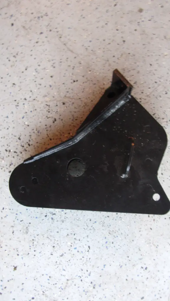

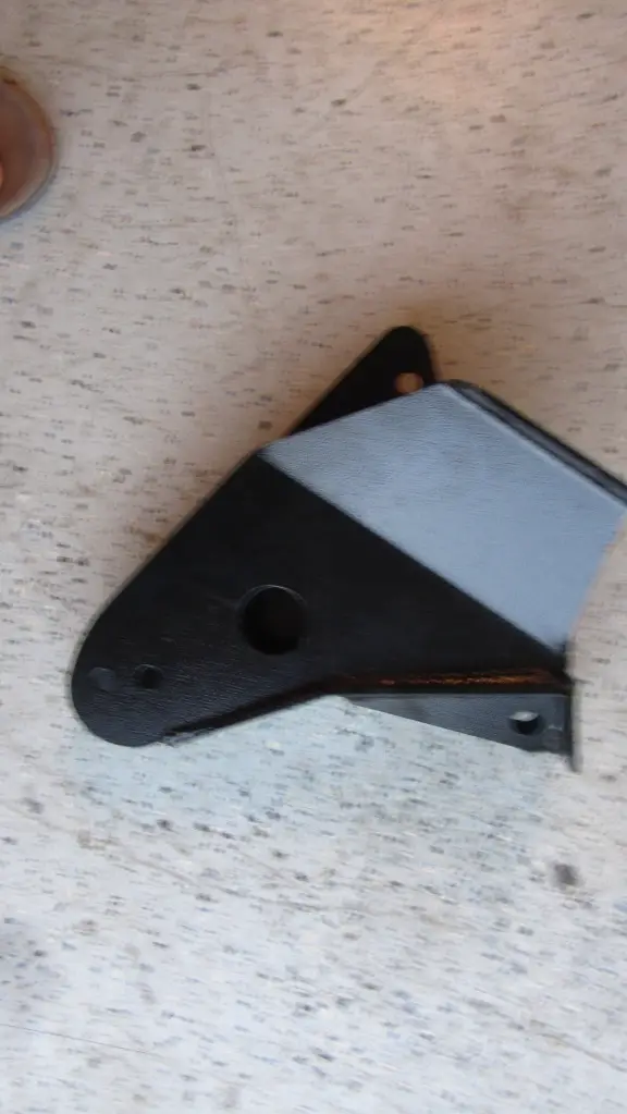

I got my I beam brackets yesterday. I will get some pictures of them. This weekend.

Took a long long time to get brackets.
seems like its been maybe nearly 2 months,m just got lucky to catch him when he was doing a run of them. I'm using one as a guide to build another lift bracket for a friend also.

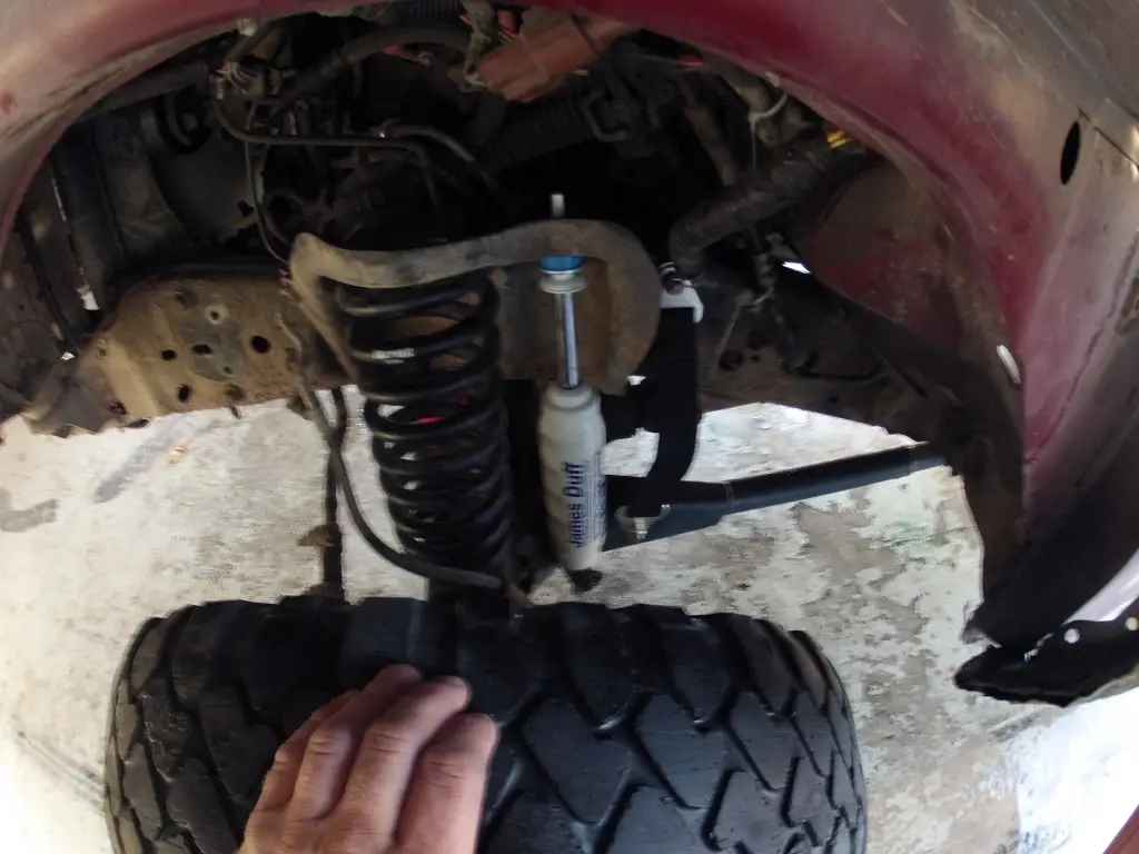

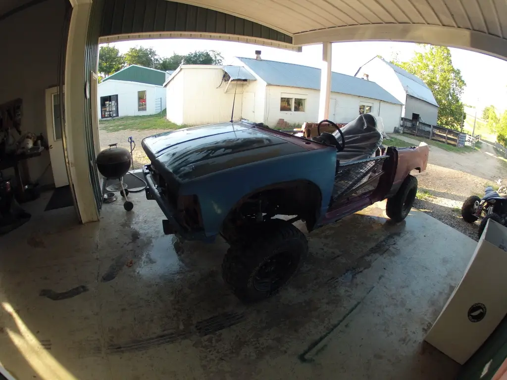

here are a few old pics of the previous setup.
Which did work great! but I wanna be wider. with stronger hubs.

He seemed to imply that the 1.5" drop brackets with a full width (I assume uncut) Dana 44 would amount to a 4" lift over stock brackets with the Dana 35. Which I kind of agree, I'd rather get a total of 6" out of the swap.
When I used 5.5" early Bronco coils on my SAS, I think they were closer to 8" of total lift as compared to the Explorer TTB 5.5" lift coils. That of course all depends on what height you mounted the new buckets.

Yea the lift doesnt come from the drop brackets, its all about what coil setup you use, I was just worried about alignment issues with 5.5 EB coils and only 1.5 I-beam drops with stock un cut beams.

Looking at a pic of the Skyjacker bracket. If use the upper hole location they use for 4in lift normally there is room for another hole 1 inch apart.

After looking brackets over the skyjacker drop bracket for driverside beam had plenty of room to re drill for the D44, but the Duff bracket would need some extra metal added. Ive decided to use this truck for different things, so sorry wont be completing this. I dont think I will be racing tuff trucks
