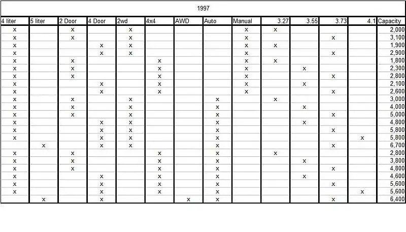

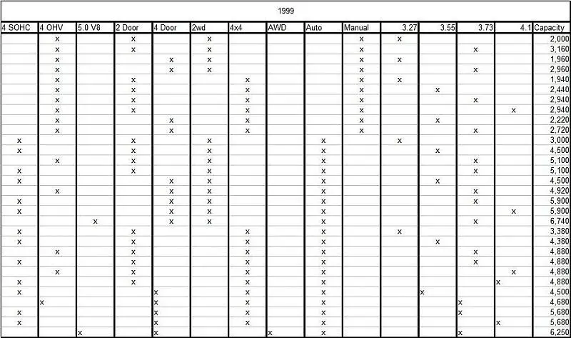

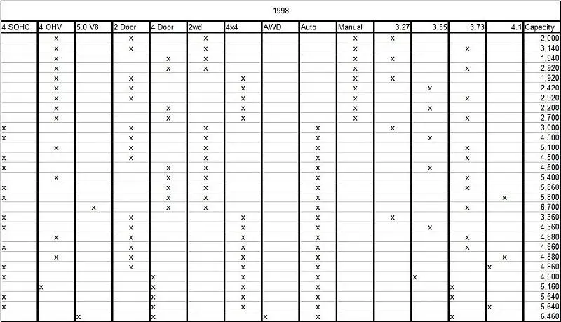

This is your max towing capacity. Meaning all cargo, passengers and weight of trailer and contents included. Don't think you can load up with stuff in the truck and still tow this amount of weight on a trailer!
does this include the vehicle weight? or just payload weight?
This is the payload weight- it does not include the weight of your vehicle, that would be the gross combined vehicle weight.

I hope these numbers are similar to a 2004 ford explorer sport trac adrenalin package.
They should be close, pay attention to gear ratios especially. I'd recommend that you check your owners manual before you proceed.

I see that you have made this chart as simple as possible to follow, but please forgive me!
My husband drives a 4 door 1999 Ford Explorer (Eddie Bauer if that makes any difference) and we currently tow a Coleman PUP. I would really enjoy getting a travel trailer but of course safety comes first. We are looking at a 1999 prowler - 26 feet, the listed weight is 4270. Is this pushing it? We just put in a new transmission this spring and it does have a cooler. Any advice will be gladly accepted!
chrisis
October 14, 2005
606
Murray, kentucky
2000 ford explorer xls
what engine you have (4.0 or 5.0) and what is your gear ratio?
after you figure these then it should be easy to trace your towing capacities of your explorer from the charts that MountaineerGreen posted.
