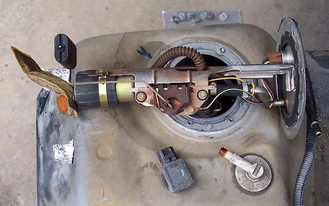

fuel level sender
The opening in the fuel tank is only slightly larger than required for the fuel assembly to pass thru it. The fuel level sender is simply a movable wiper on a resistance strip and is easily bent away from making contact if extreme care is not used when installing the assembly. Or the float arm could be jammed in the full position.
The check valve is totally mechanical and independent of electrical circuits. It can be tested by trying to force air into the fuel hose in the opposite direction of fuel flow. Little or no resistance means a defective valve.

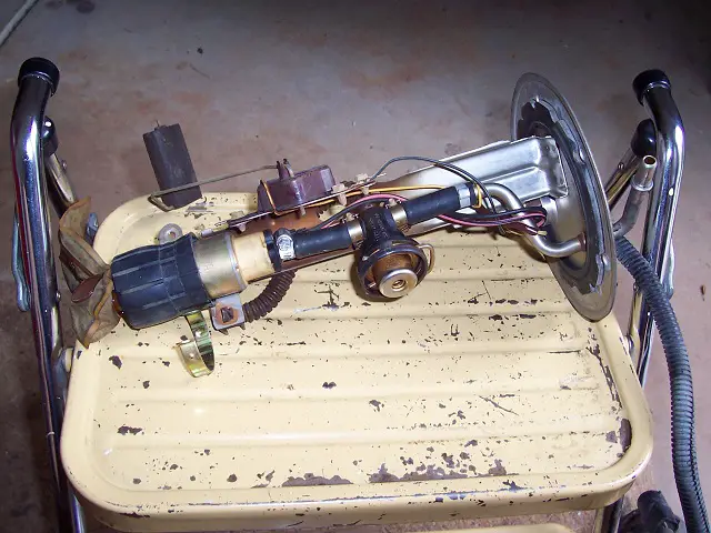

good check valve
For those numbers your fuel pressure is good and the fuel pump check valve is working fine. On 2001 and later models there is a rev limiter set to about 3,000 rpm when the transmission is in park or neutral.
