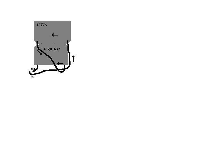

Hey James if we got the same cooler setup then the stock tranny cooler should be on the left side right? Heck all i did to get it off of the radiator and get it spaced out far is drilled a little hole in the mount plate in the new cooler and just took off my old one and with the same screws and holes in the car just attached it so that i could run it on down to the next one. Here is my ghetto diagram.
All on the passenger side. I forget exactly how the lines went to hook up to the hard lines. But i do know that whether it was left or right ones that the in line was hooked up to the pressurized side so it could pump up there and then basically trickle down through the both of them easier. Well hope this helps. I think it is the best place to mount the auxiliary cooler because it is out of the way of the other cooler and the radiator, let alone spaced out about 4 to 5 inches from the radiator. I noticed that my tranny pan feels noticeaby cooler and also it seems my engine temp guage never gets quite as high now either. though barely worth noting. Just make sure you add about 1 quart of tranny fluid plus how much ever you lose in the hookup process. If it is done with some thinking you wont even lose 1/8th quart. But i decided to flow test it all so i left the bottom hose off and turned the engine over for a few seconds. Tranny fluid all over the place!!! Well it flows good!!! Passed my flow test with flying colors. lol. So i had to add about 2 total quarts. hehe.
