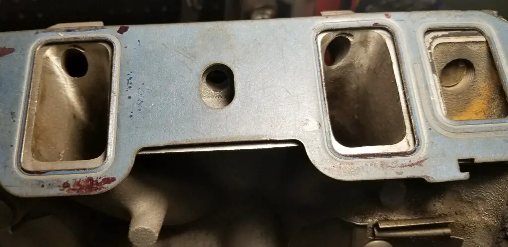

Yes, I have one that I had done on the way to our resident powder coating expert here. The porting looks okay, but I don't think it's improved a ton over stock.
For a head flow of 190cfm, a stock GT40 or P head, the stock intake is very good. But most heads people swap to are 235cfm on the low side, and many popular heads push 270cfm and more. The GT40 intake is too small for those, but if one can be ported to reach 275-300cfm, then it's a very good choice for a moderate rpm build.
