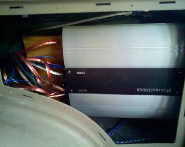

ok sorry it took so long but here is what I did with the space

Will your amp be OK upside down??
its working fine so far I dont know why it could be bad for it

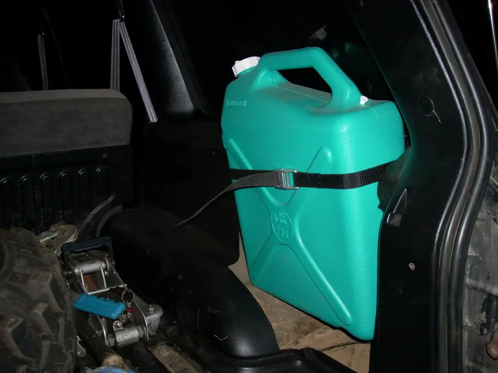

yea I measured the hole and if I wanted to I could fit a 2 gallon gas can in there with little cutting I think

The fins on the amp need to go up to dissipate heat, if you put it upside down then the heat comes back to the amp, not good....
