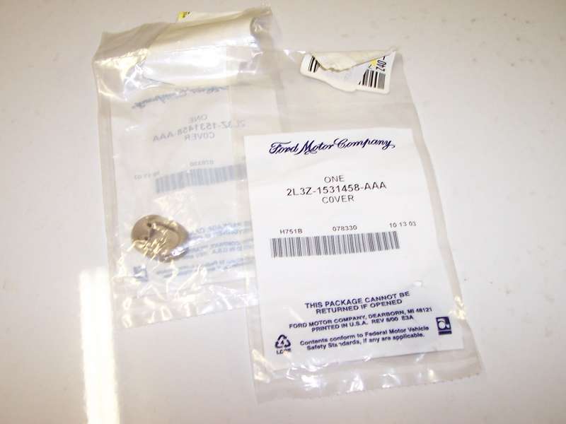

Prices: (via FastPartsNetwork)
2003 Ford F-150
2L3Z-1531406-AAA - Handle $19.07
2L3Z-1531458-AAA - Cover Clips $4.14
The Parts:
Sheet Metal Screw:
Note: I had to use a spacer between the pillar and the mounting surface of the handle - but I have to go to work and make some more spacers (so no pictures of those).
Time:
Installation: ~1 hr.
Engineering the first handle: ~4 hrs :rolleyes:
Figuring out how to make this handle work with my a-pillar was a pain, but I finally figured it out and made it very supportive! :thumbsup:
Installation:
For me, I had to find out where I wanted it mounted and then findout where I was on the actual a-pillar. I then drilled holes and then cut the a-pillar panel so that the handle will sit flush. I then put my spacer on the ends of the handle and screwed them on. The only hard part was figuring out exactly whereon the a-pillar panel you are and cutting out the holes (if you use the type of handles I used).
