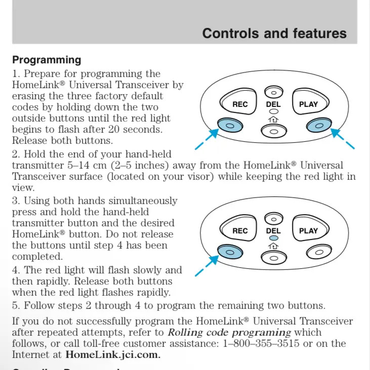

These aren’t what you need?
Thanks I just thought the newer garage openers operated on newer frequency's and might not work with my factory unit. I am looking to boost the range of my opener and have already tried extending the factory short antenna with minimal results.
