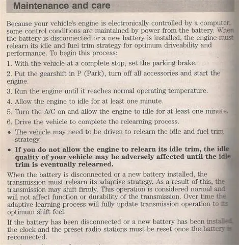

does anyone know about this and if so the procedure to do it? i lost my owners manual
You can read/download the owners manual Dead Link Removed but I don't know what you mean by relearn.
I think he's referring to the process that takes place after disconnecting the battery.
That process takes place automatically, upon reconnection of the battery, does it not? The PCM relearns certain things related driver-habits, but as I understand it, there is no real problem with switching out a battery. No? imp
From my owner's manual:
thanks everyone much appriciated it did relearn itself

I tried to do a reset according to the manual and it did "relearn" the idle and trim, but the stupid old CEL code keeps popping up and them disappearing. Maybe a short or loose wire somewhere? It keeps reading as an old code, with no current codes.
