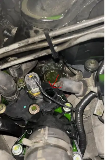

So an update! I took the Car to Valvoline to get coolant flushed- mechanic said my heat hoses were rock solid with air. He said my thermostat likely busted- So we replaced. Good news: car ran for 5 minutes and temp gag was LOCKED at normal which was great to see. Bad news: The guy couldn't get the pin on this thermostat hole. Does anybody know what this is? On my old thermo it was a hole that led no where- this hole has coolant coming out lol. Heat worked for a second or two but then it started shooting antifreeze out and guy said we'll just leave truck at shop til morning. But how does this work? Does that pin close the hole up? What goes in there lol?

Ok there is a plastic plug that goes there and that clip holds it in some models are just molded shut but in your case you could either get the plastic cap that goes in there or buy a sensor and shove it in there and slide the clip in to stop the leak

thanks! do you know name of piece?

They didn't- In old thermostat that hole didn't do anything/there was no plug. So wehn he put new one on there was nothing to fill what now had a hole lol
Will putting the clip in solve this?

The clip alone will not stop the leak also on the newer SOHC engines there is 1 sensor instead of 2 so they put in those plastic plugs to cover up the unused hole you will need to find that plug or replace the housing unless you shove a sensor in there also the thermostat is located under the piece where the upper radiator hose connects not the hole with the clip

can I buy another sensor like the one I bought already(i.e the one thats plugged in to the left of the hole) and stick it in there? I think I actually have the old sensor

yep, that'll work just make sure the o ring is on the sensor and in good shape
