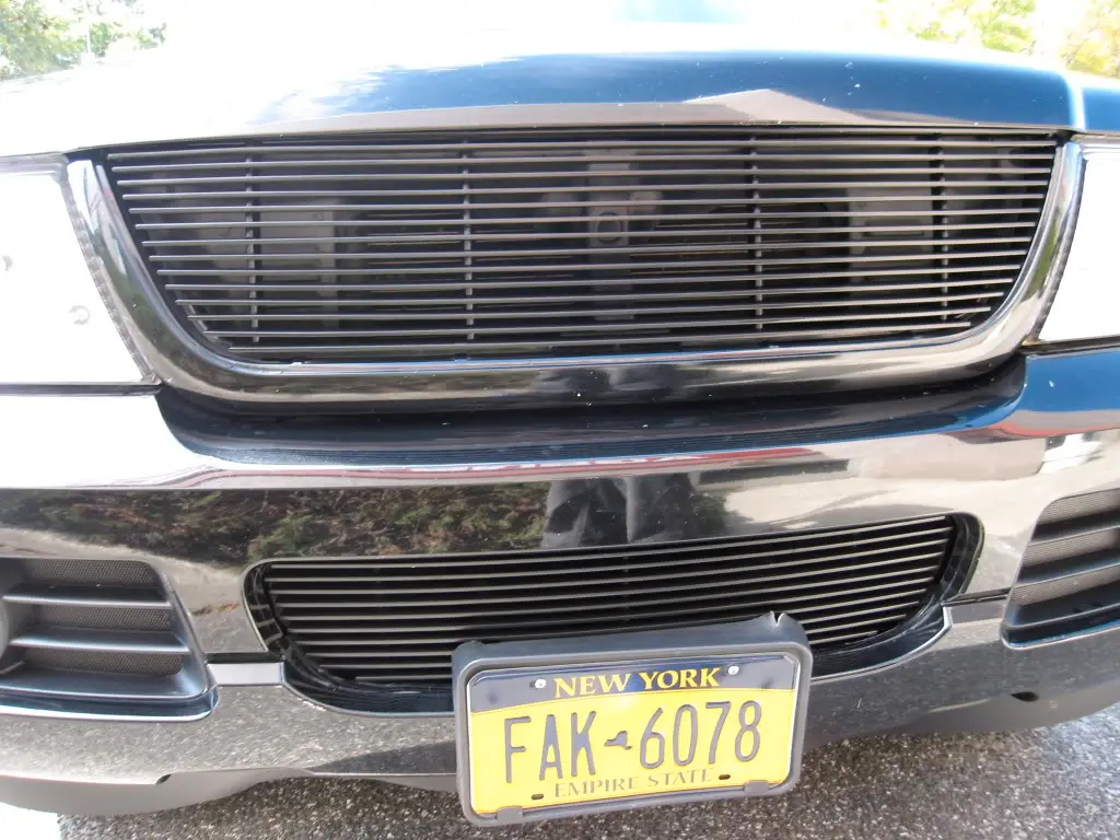

Made some excellent progress on it! How's that painted grille holding up? Mine seems to be chipping an awful lot...
EDIT: And wow....I do have to say that was a lot of pictures to look through! :D
fedyfedz
April 26, 2010
886
2
Suffolk County, NY
2002 limited v8
haha that was only half the pics i felt bad even though i could look at pics of x's all day. the grill has a few small chips in it the lower grill seems to have more. i drive alot on the highway and the bugs this summer and the trucks on the road kickin shi* up im going to wait to re-paint it till after winter as to I feel the plows when they drop sand and crap is just going to make it worse.

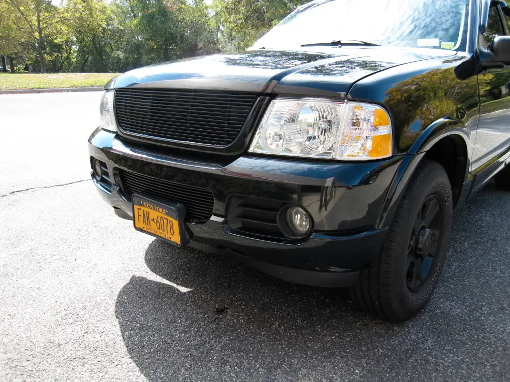

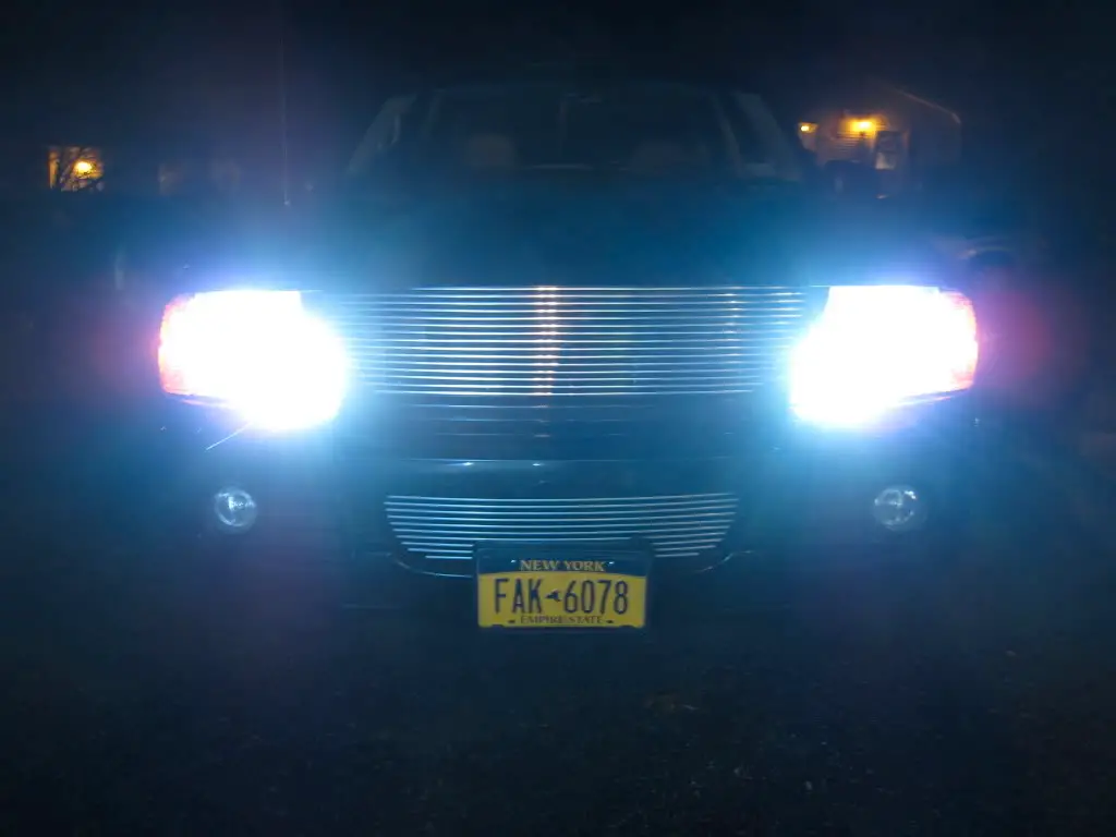

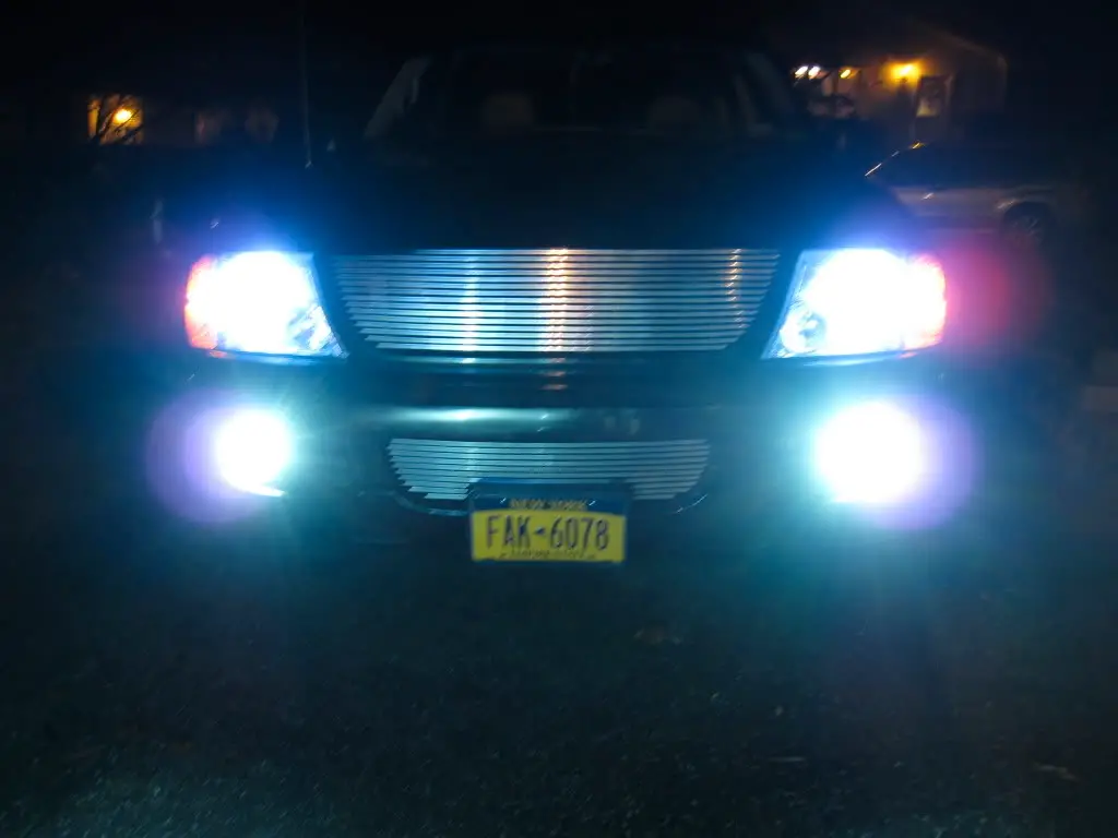

Put some hideway fog lights behind my grill

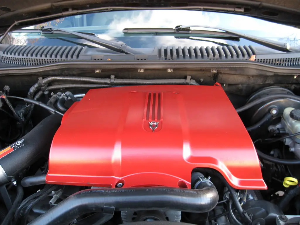

Also painted engine cover and fuse cover...

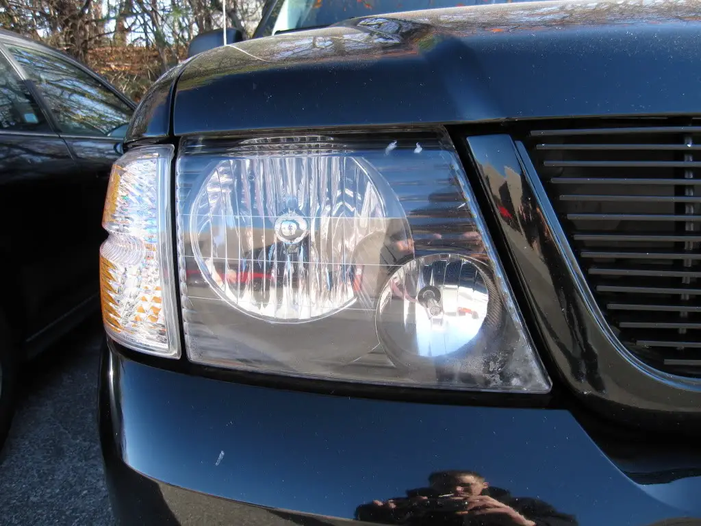

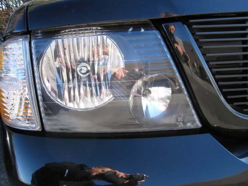

Also baked my headlights and painted inside black i only have the pics of them taped off I will update soon with the final pics just got my camera back today you can kinda see them in the pics above....Im also getting some general grabber a/t 2 tires today!!!

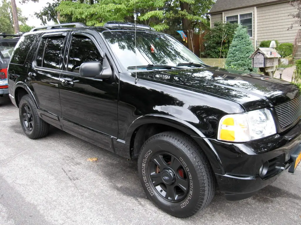

New Rubber

Nice fedy! :thumbsup: Really been working on your Ex lately. The red engine cover is B.A.!!! My 2 cents here: Paint the V8 logo black?
I like the idea of the painting the headlights, how is that holding up?

thanks alot it means alot when I get positive feed back about new things ive done. The engine cover ive wanted to do for a while.
Nate: I was thinking about painting it black but i kinda like the chrome its too cold to paint anything for me now as to i do most of my work outside :(, the headlights are holding up mint, it changed the whole look quite a bit. it took some trial and error but the end result came absolutely amazing. I was to excited to put them back on that i didnt let the sealant do its job. ended up having some extra moisture that was quite annoying. I drilled a small hole in the bottom and got all of it out and then put some more sealant and crazy glue and now its perfect. i wish i waited and sealed it up better the first time.

Hmm... I may try painting my headlights. What kind of paint did you use?
Posted via Mobile Device
i used Krylon Fusion Spray make sure its for plastic. then used a coat or two or clear coat as to you do not want to have to do it twice. and they are always in the sunlight.
and keep an eye on the headlights when u bake them in the oven. I did mine at 350 degrees for 10 minutes or so and they came apart rather easily, my friend who did the same thing in his ranger took slightly longer and he ended up spider cracking one lense casue he left it in to long.

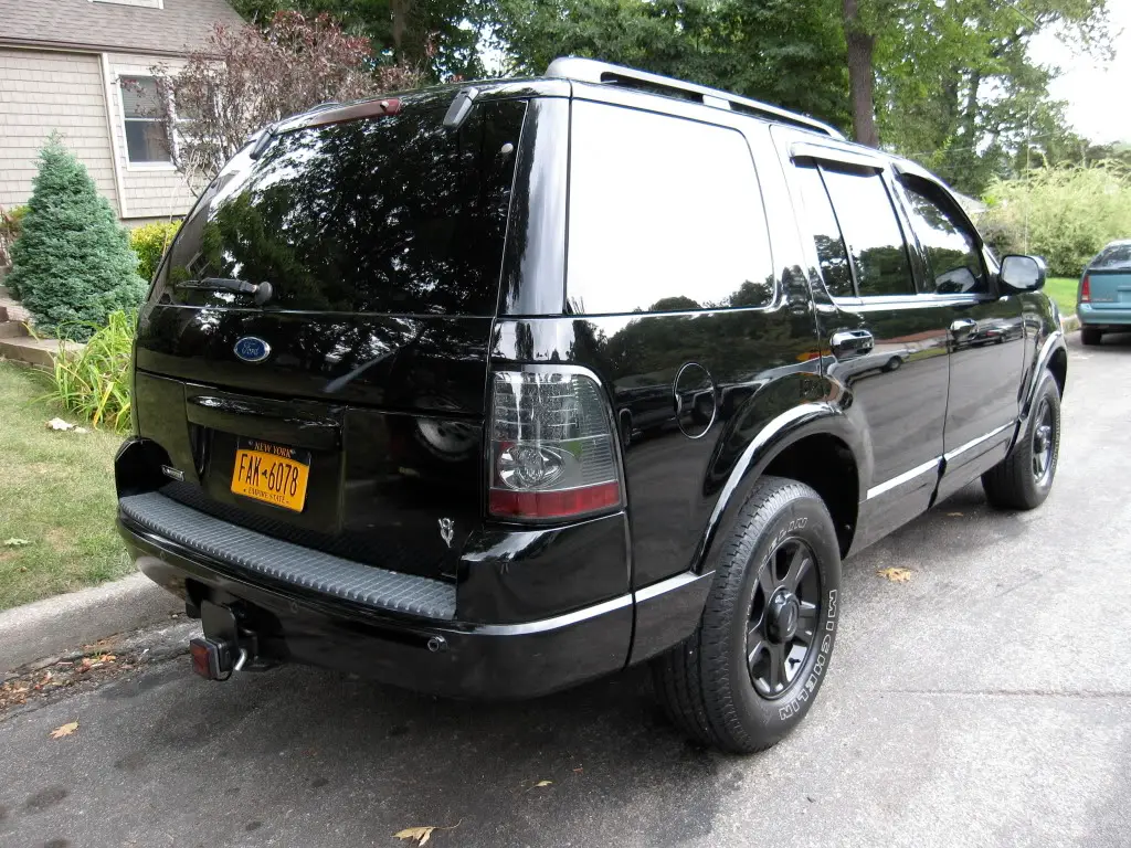

New thunder grille
new led tailgate strip
also added this to my posse
before:
After:
