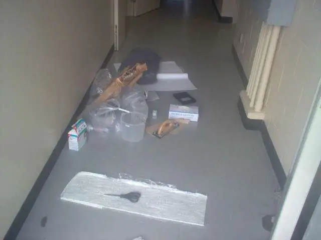

Well, the other day I recieved my sunvisors from my house in Birmingham, Al. I am in Okinawa, Japan currently. I went out and bought some fiberglassing materials and resin and all the accesories to do it. I had installed my 6.5 inch tv's, previously into my sunvisors and now they are removed. I would like to take the sunvisors and fiberglass them. I would like to make the bracket or frame of the tv be flushed into the fiberglass. I am wondering, can I just soak the visor material in resin first then reinforce it with some 1 1/2 oz. fiberglass mat? I know fiberglass does not stick to plastic. I read up on an article which said to drill holes in the frame sides and fiberglass the underside of the frame and the top of the frame, making sure to let resin seep through the holes to adhere to the plastic. Is this correct? I need answers fast. The weather has been really crappy here for the past two weeks. This is the first day that it is looking nice and sunny outside. I would like to get started immediately. Also, the seam of the visor where the corners and the bottom where it is sewn together leaves a deep crease. Can I just fill that crease in with body filler and sand it smooth after I fiberglass it?

Day one with pictures first of the cut out hole of the sunvisors and with the tv frame sitting inside the hole for an idea of what it will look like. I am going for a three dimensional look. The fiberglass will move up and over the frame off of the visor itself. I stuck a piece of cord through the visor to hold the hole for the wire coming off of the tv. I did not want it to close up and have to drill it out.
These next few pictures are of the first day of fiberglassing
Here are some photos of the second day of fiberglassing
You can see that I have a slight angle on the top, coming out a little on each so it kind of tilts toward the eyes a little. I know they will be a little heavy, but I don't plan on flipping them back up. I want them to always stay down. In a few days I plan to fiberglass the back sides of them and then sand and start to bondo them smooth. This is my first fiberglassing project. Please help with any constructive criticism. Bare with me as the process may take a few more days. This thread already went three pages down the line. I have also already purchased some stock sunvisors for my truck just incase I don't like where this leads to. Something to fall back on ya know?
