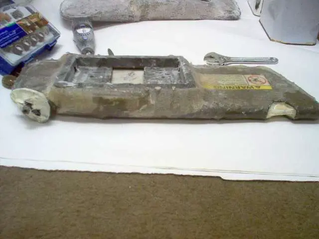

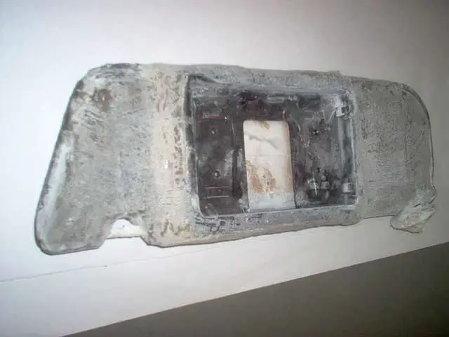

Update: We had a Typhoon here in Okinawa hit us and I was restricted to the barracks and my project is at work. I could not leave from Friday night until Sunday afternoon. I did not get a chance to do much. I cut a little off with the Dremel tool I bought. I will be trying to perfect the fiberglass this next weekend and maybe bondo a little. We'll see. Quick question though. The fiberglass is trimmed away from the center edges now and I am curious when I sand smooth to the edge of where the tv will be inserted, should I fill up to the edge with 4058 duramix to the fiberglass? Or will bondo stick to the plastic? I was told Bondo won't stick to plastic. The only reason I got the fiberglass to stick is because I sanded the plastic really rough first. I was thinking duramix will stick and adhere to the plastic and I can make it contour and adhere to the edge of the fiberglass and then sand smooth and add bondo as needed. Is this correct?
