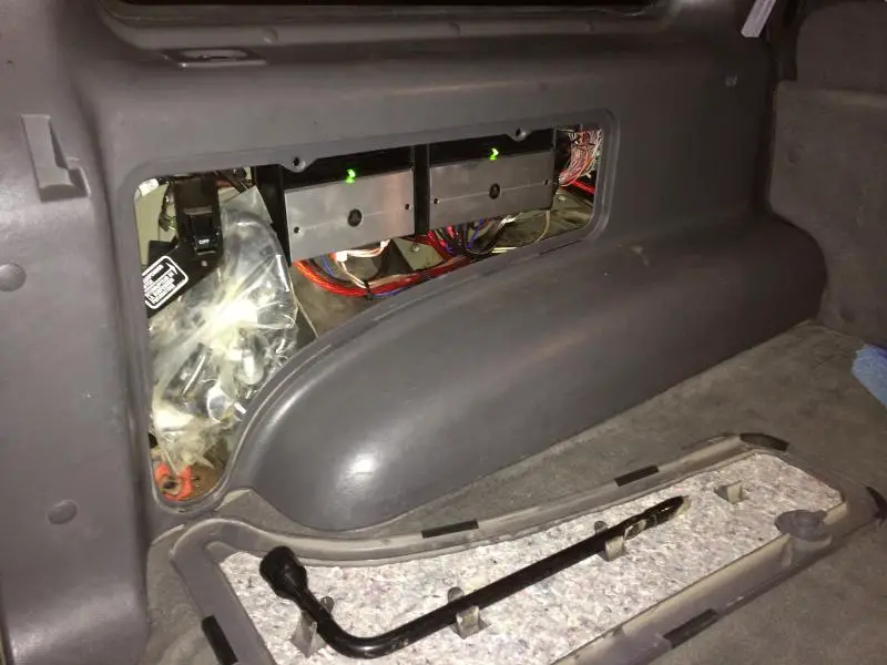

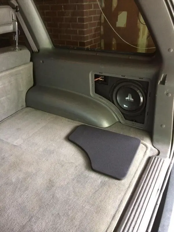

I recently completed my custom stereo installation in my 2000 4 door Limited. I am running JL Audio TR570 satellites in all 4 doors, powered by a JL XD400 amp. In the trunk, I swapped out the stock sub and box for an MTX stealthbox, with a single JL 10W1V3 10", powered by a JL XD300 monoblock.
I had good luck hiding the amps behind the factory panel which houses the bottle jack and lug wrench.
