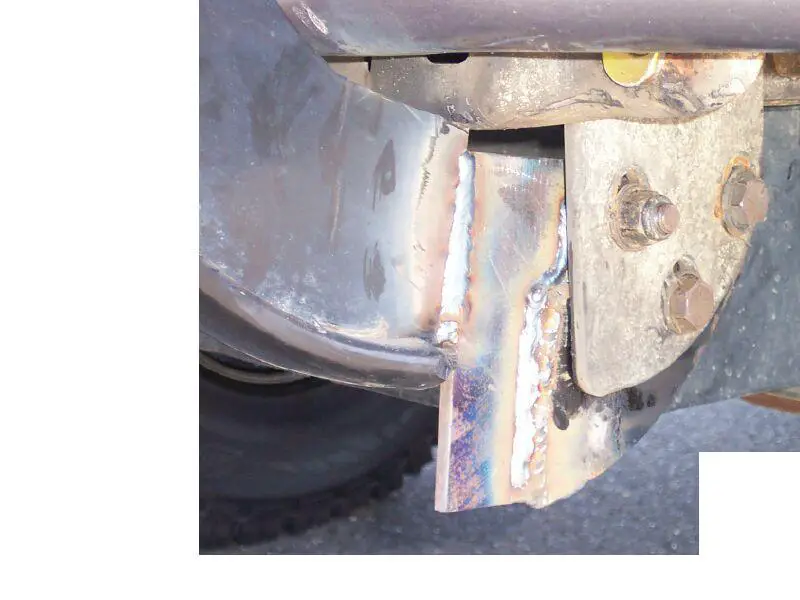

Heres how we did my brush guard. After this i used a grinder to get rid of the pointed edges and painted it with black enamel.
Well if its not exact i could always just modify them right?? i was thinking of just drilling new holes in them or maybe making the holes longer if they really arnt gonna line up... and maybe cutting some off the ends if they really wont fit up next to the frame.
thanks for the pic sk1er. How did you know mow much of the brushgaurd to cut out? do you have measurements by any chance??
it took 3 people...
if you look close you'll notice i didnt "cut-out" anything. My neighbor and i took an educated guess and made a straight cut down. then we mounted the two pieces on the frame like they would normally be... we then had two people hold the brushguard in place where i wanted it to sit after the mod... turned out that a 2.5" wide rectangular piece of steel fit in perfect... we prepped it- had two guys hold it in place, set a few tach welds. Decided it was sitting perfectly and finished the welds.
Hehe, all you suckers with 98s-... us manik 99's can just drill new holes and make a small bracket to move our brush guards.... the drop brackets are huge. Mabey you guys could use our brackets for relocation?
that might not work either. if you can see in my pic- the brush guard not only had to go up, but it also had to go almost 2inches forwards. my way took less than 2 hours- its strong, looks great after a grinder and some black paint- and those welds are stronger than the metal the brush guards made out of. either way you go its gonna take some mods.
