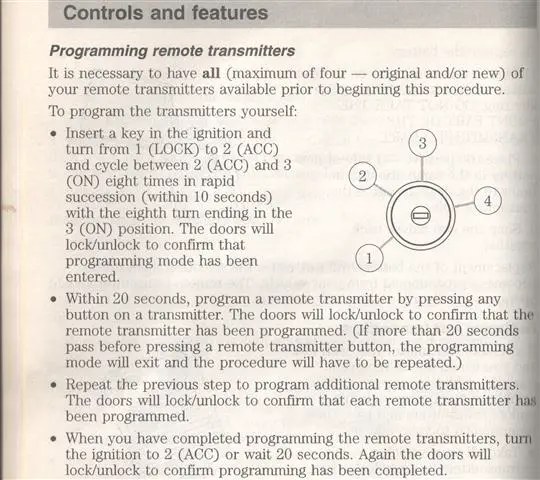

Hi everyone, I got my first Explorer, very good price but a few issues. The truck only came with one key, no remotes. I purchased a new remote but cannot get it to programme!
When I can get the truck to enter programme mode (locks cycle) by flicking the key on and off eight times so I know that is fine...but nothing happens when i press any button on the remote.

The steps for programming the key fobs is in the owners manual. If you don't have an owner's manual, Dead Link Removed. Is it possible that the remote is not the correct one for your vehicle?

Thanks for the reply BigRondo. I have followed your instructions several times...BUT the question remains, Is this the remote for this car?? How do I find the answer to that?? The auto shop I got this from got the 'model' from a manual, but could NZ new explorers be different from others as far as these remotes go??---Very blabby, but I guess I am saying I simply do not know if it is the right one (has four buttons) and how to tell??
