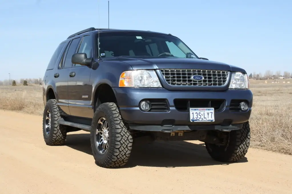

Limited, If you went to Estes Park you drove right past me! Im right at the front range of the mountains. Next time let me know when you're coming and we'll hit up some trails in the EX.
Miller...
What kind of a lift you got on your X?
You about have the lift hieght I want to get installed on my X.
3" body and 2.5" Truxx strut spacers
That thing looks great! Nice work! :cool:
