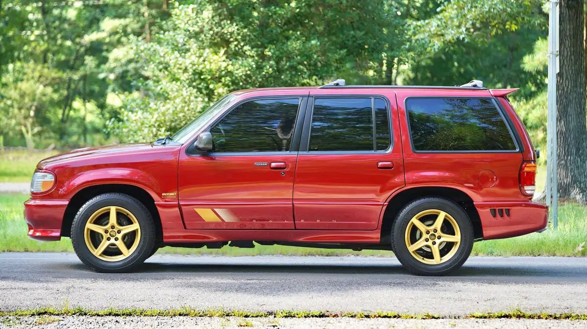

Thanks Don. I think RubySlow had his like that at one time (see photos). I also remember of some photos of someone’s flowmaster mufflers flat and staggered but can’t seem to find them.

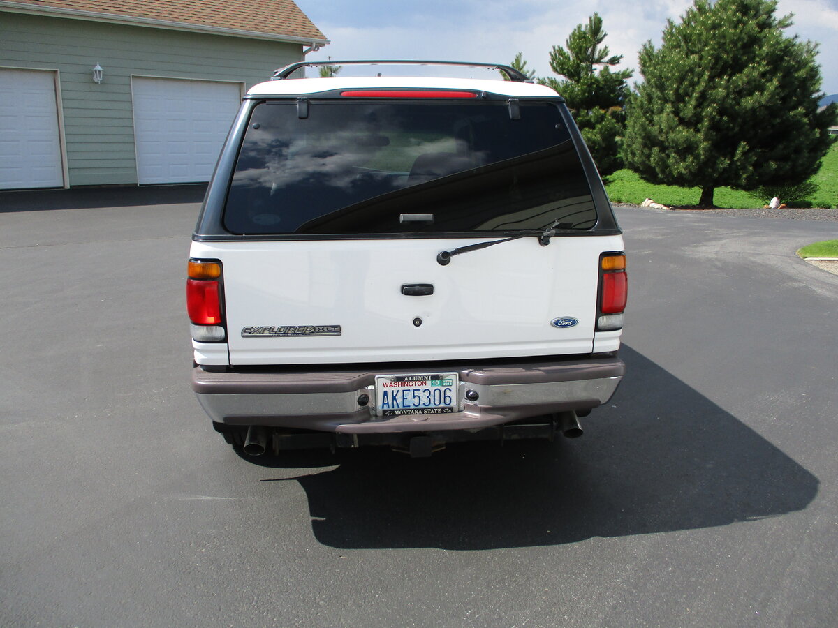

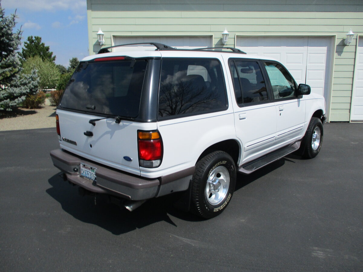

I had a '97 XLT with SOHC. I had replaced the dual inlet / single outlet with two Flowmaster 50 series. Placed them in the conventional position under the rear passenger and ran dual exhaust over the axle and out the rear using Gibson slash-cut stainless tips, one on each side. The spare tire was removed. The mufflers were mounted at an angle about 40 degrees off vertical with no heat shields. Yes, there was some of the muffler that was visible from the side but it wasn't objectionable. The truck is still being used on a daily basis by the person I sold it to. Photos were taken in 2018 with 170 k on the clock at time of sale.

I had a '97 XLT with SOHC. I had replaced the dual inlet / single outlet with two Flowmaster 50 series. Placed them in the conventional position under the rear passenger and ran dual exhaust over the axle and out the rear using Gibson slash-cut stainless tips, one on each side. The spare tire was removed. The mufflers were mounted at an angle about 40 degrees off vertical with no heat shields. Yes, there was some of the muffler that was visible from the side but it wasn't objectionable. The truck is still being used on a daily basis by the person I sold it to. Photos were taken in 2018 with 170 k on the clock at time of sale.View attachment 424784. View attachment 424785

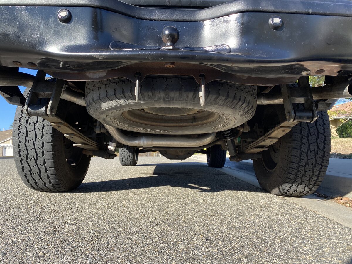

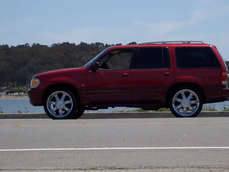

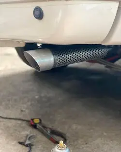

Here's a few pictures I saved of a couple of other member's tail pipes. The size will effect how possible it may be to get around the tire and the brake line etc.

Muscle Junky, I don't have any photos of the underside of my white 97 showing pipe routing & muffler placement nor photos from the side like the red Explorer above. Sorry.
