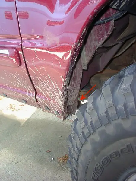

Many people have asked just how much I had to trim to fit 35x12.5's on my new model explorer when I only had ~4.5" of lift.
I figure a picture is worth a thousand words so:

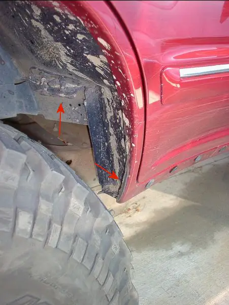

Front End:
Red arrow indicates start of modification. By the bottom I think 3-3.5" are removed from stock.
Red arrow showing where I removed pinch weld

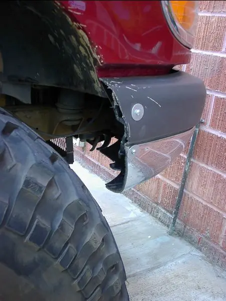

Bumper modifications. Bolts are holding plastic to the metal 'frame'

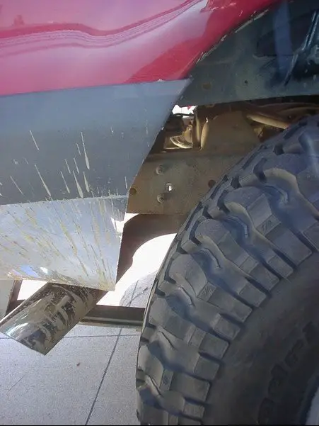

Rear End:
Red arrows showing where I bent the metal edges away from the tire

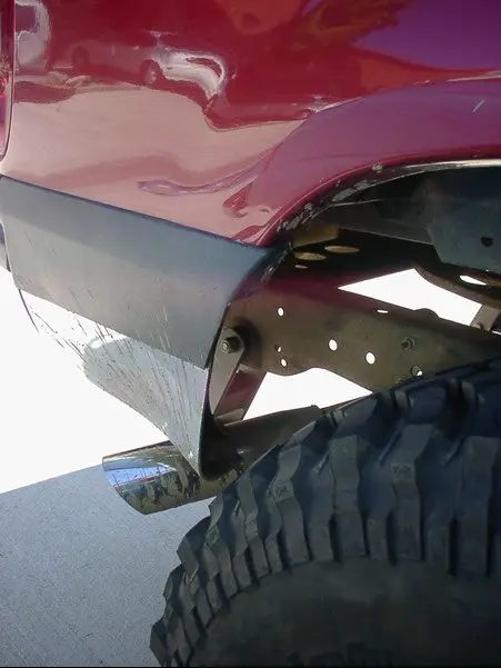

Rear trim modifications

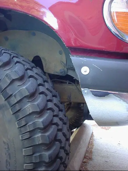

With this current setup I have eliminated all audible rubbing with the exception of when I stuff a front tire all the way up. Then its only very minor, and not very often. In the rear it still touches the front of the wheel well but I don't want to cut that for fear it will look bad. The rear also touches the top of the inner well at full stuff

Fenders
For the fenders I taped where I wanted the new fold, removed from vehicle and used a jigsaw, sawzall, hacksaw, and whatever else I could find (:shoot: :hammer: ;)) . . .leaving an inch of 'unwanted' metal to create a new fold. I then used vise-grips and folded the remaining metal over.
I then used a sawzall on the pinch weld, and welded the fresh cut back up (no negative effects so far :))
Remount fenders

Mark bumper with tape. Remove bumper, drill out rivets drilling through bumper. Install bolt washers and nut where rivet was. Cut bumper along tape with circular saw (makes for a straighter edge) or sawzall.

Remove tire. Take a BFH :hammer: to any metal causing rubbing.
Mark rear trim with tape. Remove rear trim (two nuts, two 'push-pins', and three plastic 'clips') Take sawzall to metal beneath trim. Use jigsaw/circular saw on trim. Replace trim.

cool but it looks as if I went that route id have to trim right into the stock tupperware flares hrmmm...

Jefe, where it says removed the pinchweld...how exactly was that acomplished? like cut it off and welded it back together, or gusseted it, or ???

Yes, those who still have their 'tupperware' (fender flares included) will most likely have to trim some of it out.

ahh....cut it then weld up new line...got it.... did you arc or mig or tig it up?

jefe, when you removed the tupperware what did you put in the holes? i see the little black things but where did you get them?
