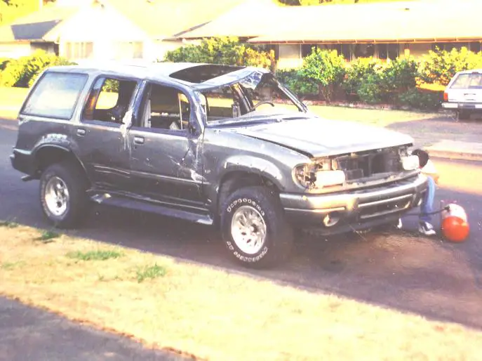

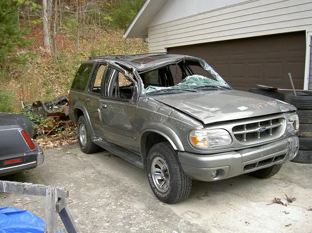

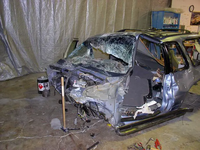

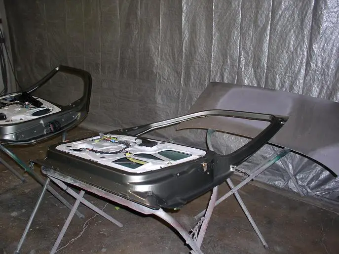

Ok so these are fixable Get a front end collision X year doesnt matter a whole lot 91-2001 95-01 preferable though.

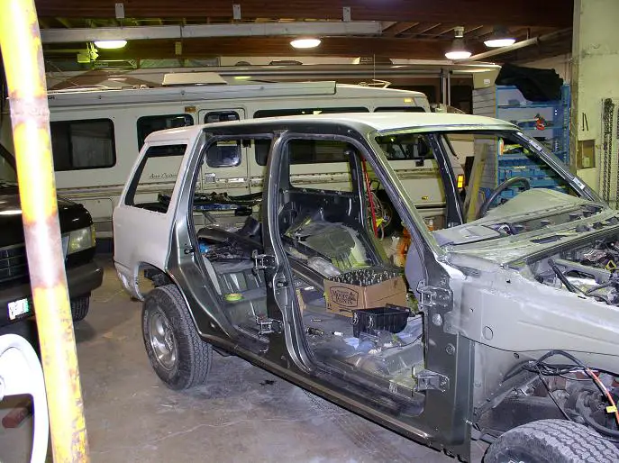

Take the seams apart @ the spot weld them back together. Most of the spot welds I have found line up almost exactly. Take cross measurements to make sure it is square. Tack weld and measure again fill in all the spot welds grind down do body work. feather and prime seal and paint.

More fun
Ok so this was a 60 hour job

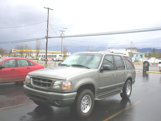

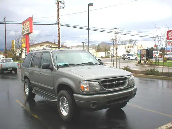

Final fun and finish
Make them look Like new again.

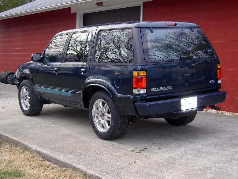

This was a cost of $5200 dollars to repair not counting my labor the paint job cost me $3500 with the extra body work the body shop had to do. I got a white 97 X off Craig’s list for $1000 dollars front end collision. De gloved so to say and put its body on my 2000 V8 limited. The rest was misc parts. I used the Glass off the 1997 which I think looks better because it had a slight gold tint to it. Used the back hatch off of a 1998 sport I Trashed. I two toned the interior (headliner and oh poop handles) with the Dark Grey interior that was originally in the limited with the light grey in the 97. That was because the 1997 did not have a sunroof. I got new rims and tires I am not counting in the price tag. It had 17000 miles on it when it rolled. I just sold this X to my wife’s friend with 87000 miles on it. She loves it.

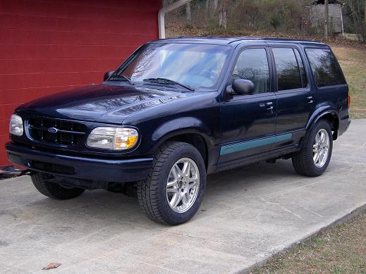

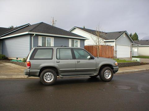

Good work there, and does this look familiar? This is my 99 when it was stock, and after my repair using my old 93 Limited for the rear clip. I finished most of it a year ago. I still lack the air compressor, running boards and front flares. http://www.explorerforum.com/forums/showthread.php?t=146519 Regards,

It does look great, but actually he changed a lot, the running boards, fender flares, and door trim for sure. After doing it I should have also left off the fender flares and used my old 93 running boards. It's all good,
