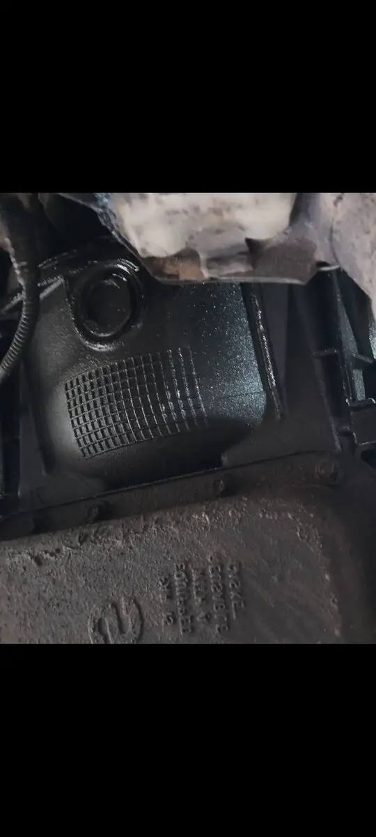

Ok so I got under it before it started raining and it looks like it's the CV joint on the driver's side. Here are some pictures. There's oil and goop that sprayed out behind the inner joint. The blowback is covering the front bottom of the vehicle almost to the passenger front wheel. The outer CV joint is clean though. I couldn't get better pictures of the inner CV joint, and the pictures aren't the best, but the shinny stuff is the oil and goop covering what I think is the oil pan and surrounding area.

Not sure if CV is shot or if that is differential oil from leaking diff axle seal. Be sure to get a front left axle seal also.
And rear main seal looks like a normal leaking ford to me.

The cv joint looks okay
The wetness COULD BE from a leaky seal on the differential pretty common
But before your mechanic goes replacing the seal first make sure the differential breather tube is clear and not kinked. If the differential cannot breathe through the breathe tube then oil will push out past the seals
However your mechanic will want to follow the wetness up as high as possible to find the leak, could also be power steering or a valve cover....

possible drivers side inner axle seal at the differential
