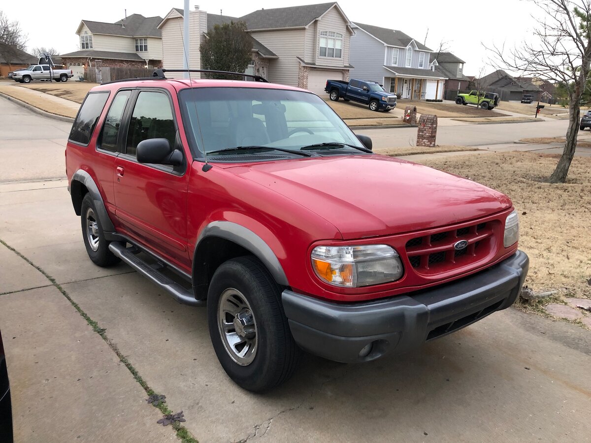

I recently acquired a 99 Explorer Sport. It's not to bad needs some work but what drives me crazy is the tires and the flares The tires are 235/75/15. Of all the sports I see none have the tire so far from the edge of the flare. I'm going to change the tires out eventually. Any ideas why
On the photo it doesn't look unusual to me. I find it typical for these Sports with the plastic fender flares sticking out so far to look this way.
If that bothers you so much and you're willing to invest the money then, I'd say consider going with different rims and tires.

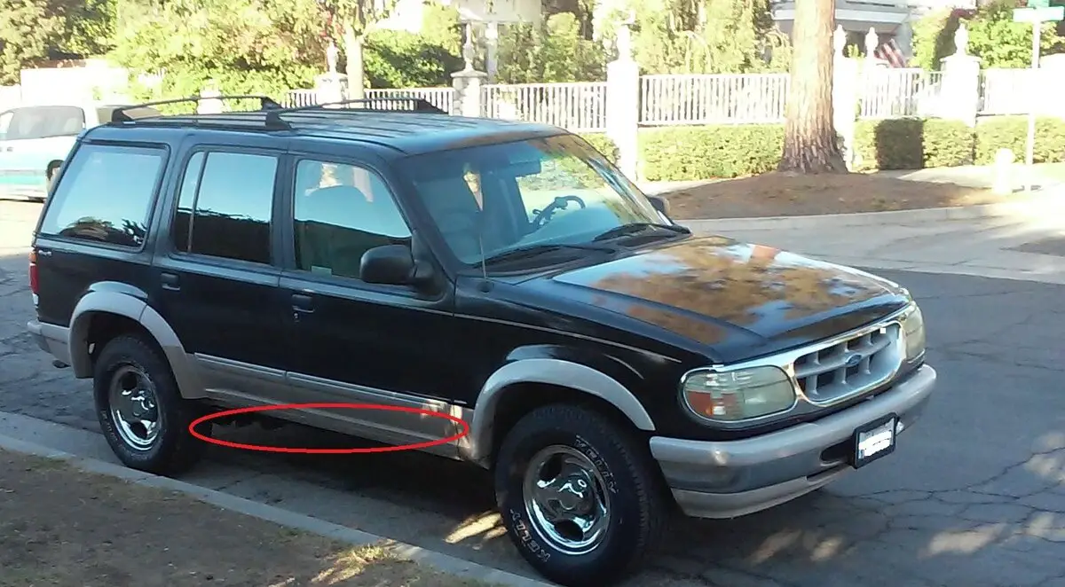

You should see the 99 EB flares. It looks comically bad.

As GE mentioned, it's not going to be as simple as tires and rims to make up that much difference. There will be clearance issues to make up that much difference unless you use spacers and I'm not a fan of them.
As already said, tires alone are not going to change that. You will need new rims with less negative offset, but watch turning clearances in the front. As you move the wheel outward the arc of turning travel grows.

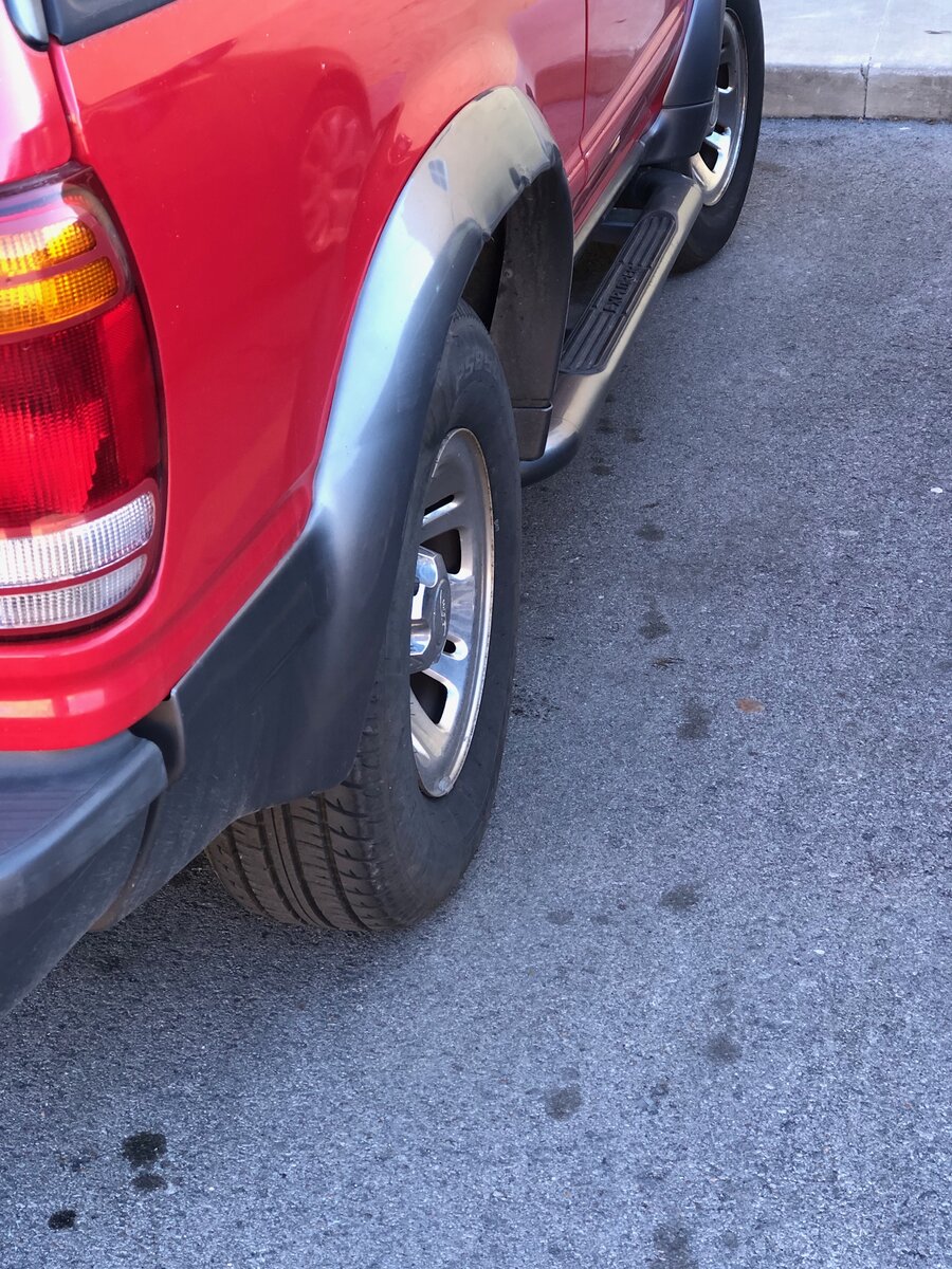

Yes they're mounted with a few screws below and clips on the outside that go through holes in the metal fender. If you take those flares off you'll need to do the body work you described to fill the holes and paint the fenders, or you could theoretically mount flares that don't extend so far out, but I don't even know if anyone makes and sells any after market ones, or if fender flares from previous Explorer years would fit.
Pull the flares off and all the running board trim. Looks better and will help not to trap dirt/moisture and rust well openings. Wider tires with correct offset would probably do lots to fill in that space.

Maybe that was the flares you got if you had the optional 16" wheels and tires? I had a 2000 sport with 15" wheels and 235/75/15 and I don't remember them looking bad, but the truck and the flares were black.
^ The 16" wheels had 255's (instead of 235's) so only 1cm difference in how far they stick out.
I like them on my E.B. ...but I have 16" wheels... and having a 4 door it's better proportioned. Gives it a bit of off road / Wrangler touch. (Disregard red circle)

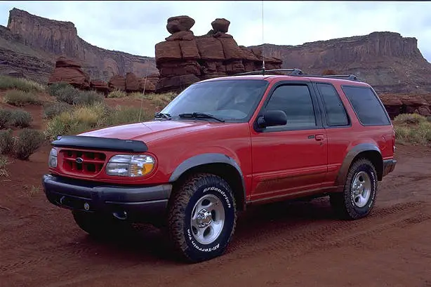

This is what I would like and what I have
The top vehicle has a 2" lift and 31" (x10.5" wide, probably, so would stick out 0.6" further than your 9.3" wide, 235's) tires. That may be the only difference, since it does have the factory rims still.
You can get that with a torsion twist in front, a 2" shackle lift in the back, and your 15" rims will take 31x10.5R15 tires.
