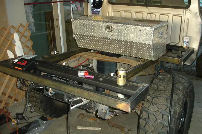

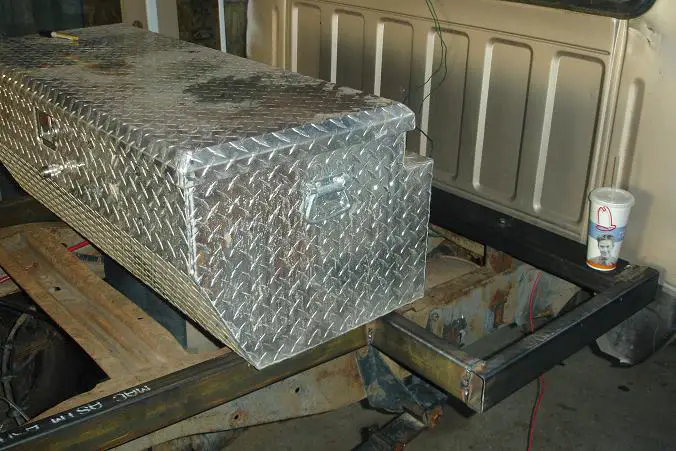

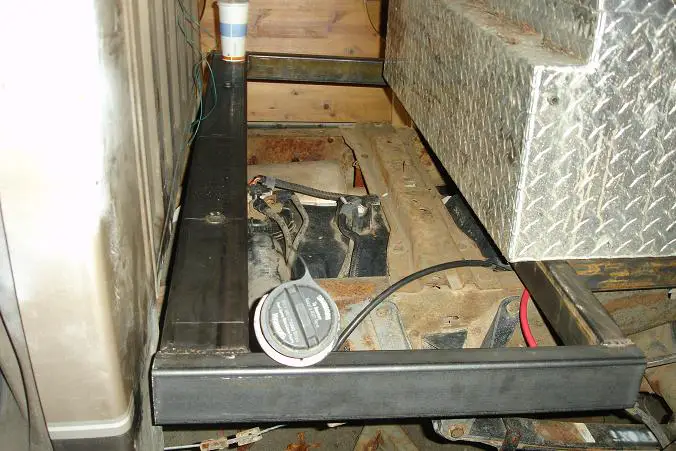

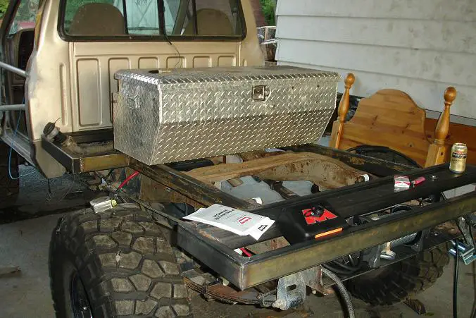

Got the majority finished. Just need to make a bracket for the fuel neck, modify the winch clutch lever, and mount the tool boxes.
The tool chest will actually be sitting closer to the cab then is pictured. It will be recessed into the flat bed frame about 1". Also will be installing a battery box, an ammo can storage box and fabbing up some way to mount the spare tire. And wire everything up.
Still need to hash out the design of the rear bumper area and possibly seeing if I have enough large scrap pieces to do up a front winch bumper.

Looking good. Have you thought about fenders or are you just going to leave it open wheel?
I'll probably just leave it open. Don't feel like trying to bend up 2 flat sheets with the same radius for them.

I do have the tool chest cleaned out and mounted and have the winch solenoid box mounted.

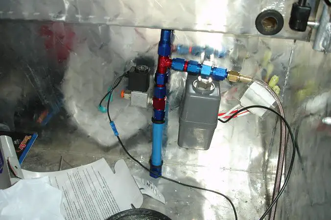

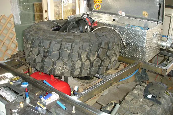

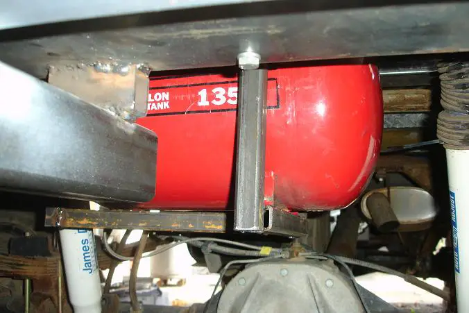

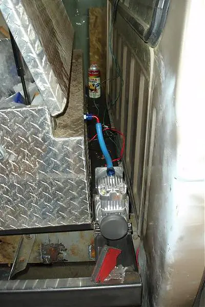

Got some things done the last two days. Got the tail lights/rear fascia area done and wired up. Got the a tire carrier made up, just need to find a piece of scrap plate for the mounting flange. Relocated the air tank.
Current to do list:
-fab up battery box
-re-install & wire OBA system and plumb air lines the the front and rear bumpers and to front ARB-tank in
-fab up front bumper for winch and 2 sets of KCs
-rewire all electrical accessories
-Got the tire carrier done, just need to drill some holes to bolt the spare down with.
-The air system it done with the exception of the line to the front bumper.
Still need to do:
-The battery box
-Front bumper
-Lay the deck down & Line-X it
-Wire up everything.

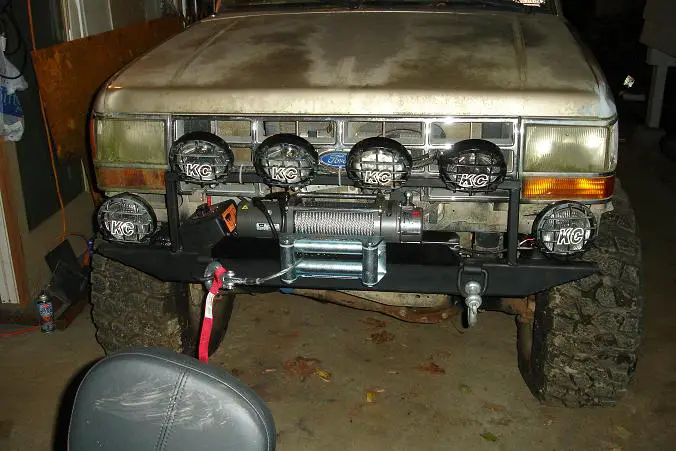

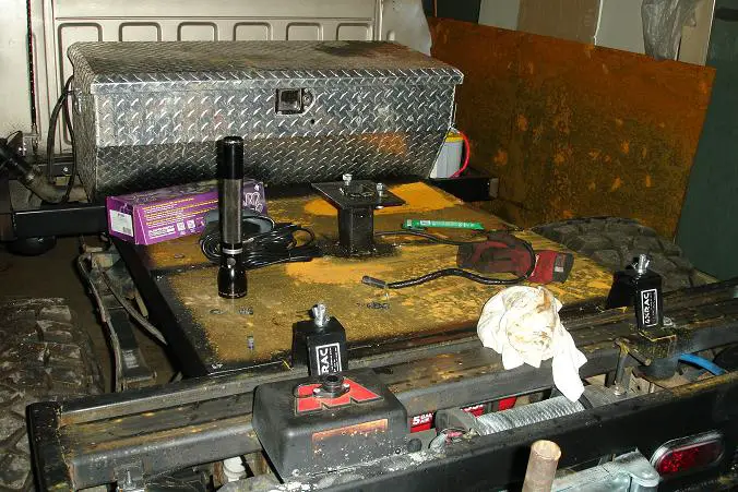

Its been awhile since I posted any updates. So here you go.
The first is of the front bumper with the winch mounted and all 3 sets of KCs relocated and wired up. Yes, I know the lights are not aimed yet.
The second is of the almost finished decking on the flat bed. Still need to add one more piece on the back portion.

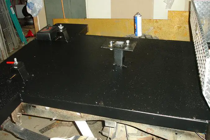

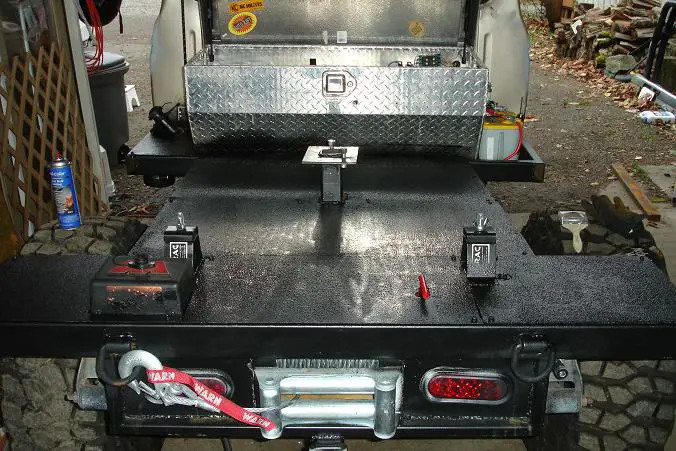

Got the rear decking done and Line-X'd. I'm happy to say that no Hootus was injured in the painting of the decking.:D
