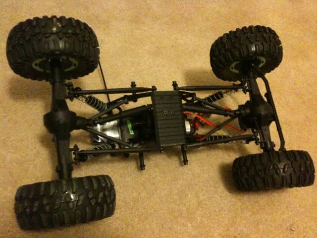

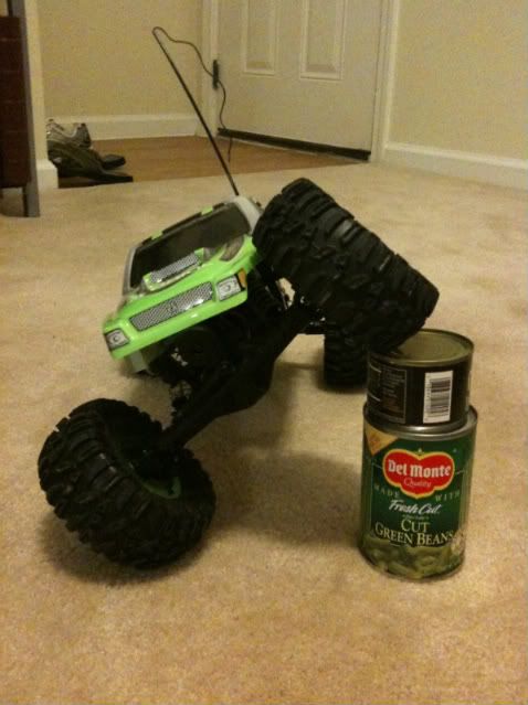

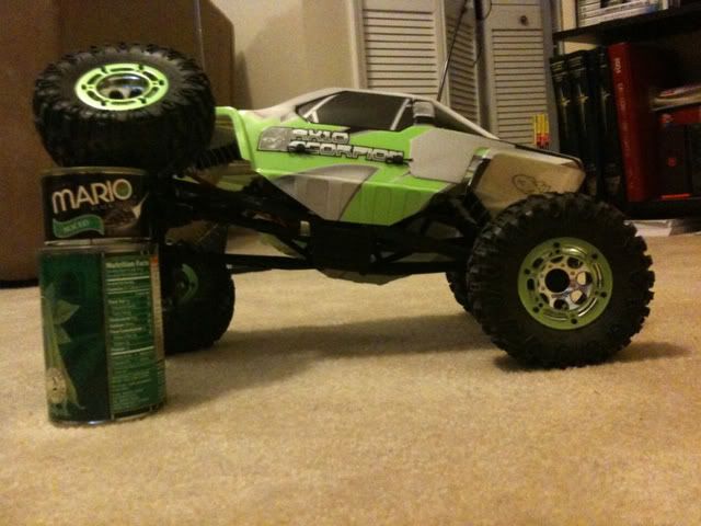

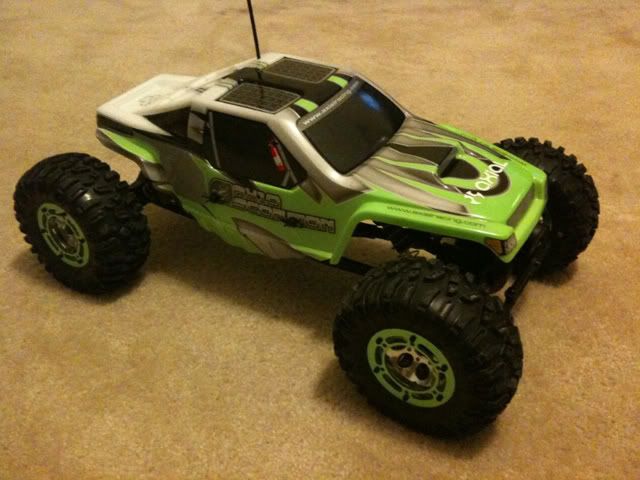

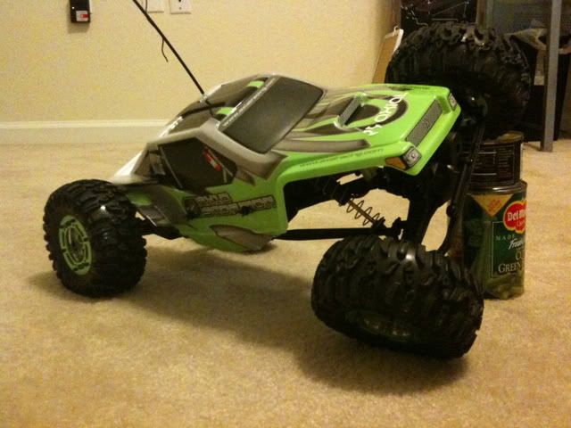

Well since I moved to Texas to continue my pilot training, I had to move into an apartment with no garage, and no real way to work on the Explorer. Add the fact that I'm no where near any hills or mountains to go play in, I had to get my crawling fix some other way.
Froader's AX10 adventures inspired me to check out my local hobby shop and they had an AX10 RTC (ready to crawl) on the shelf. I wanted the kit to build myself, but this was by far cheaper since it came with all the electronics sans battery and charger. I can still upgrade a lot of the pieces and probably will here pretty soon. I already had some drive shaft carnage due to a loose set screw.
The future: new paint on this body; new body styles (perhaps modern F-150, or military HMMWV); metal axles, drive shafts, suspension links; rear steer.
What do you guys do about the antenna? Is there a way to route it under the body that allows for good reception?
Enough talking, here are some pics of it veggie crawlin:

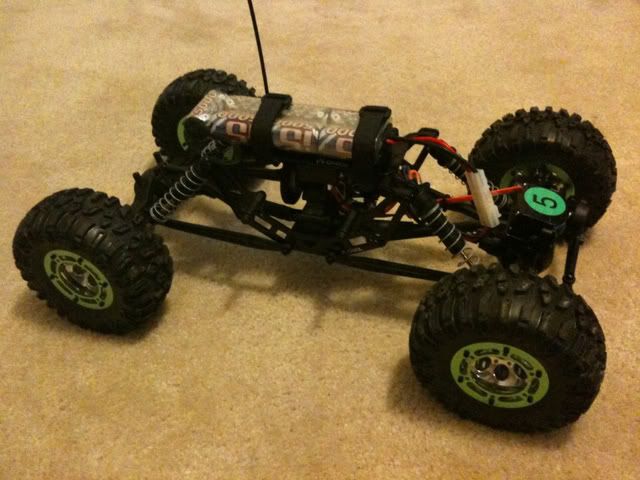

The first thing I would do is figure out a way to lower that battery. It will crawl ten times better.

Thanks guys. I've lurked around on rccrawler for a bit, seeing what options were available. I took the truck out to some rocks today to see how it performed on the real stuff and I was pretty happy. I brought along my hex wrenches tho, since the front driveshaft u-joint kept slipping off the t-case shaft. The front shaft fell off twice, but it was after the rear shaft fell off that I decided to call it a day. Just tightening the set screws wasn't enough to hold those things down.
So I took my trusty Dremel to it, and etched out a detent for the set screw to go into and hopefully prevent it from slipping off the shaft. I also drilled some 1/8" air holes in the inner wheels (2 holes 180* apart in each wheel). They should let some air out and increase traction as necessary.
I want to add some weights to the wheels next, and try to find some saddle type batteries to relocate them on the axle. That's what I get listening to the lady at the hobby shop and getting this beefy 7 cell.
