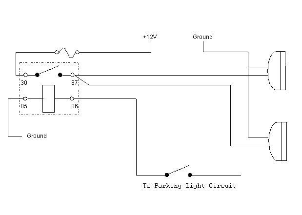

I would highly recommend using a relay! I have my lights wired so that they can only come on with the parking lights and I have a switch also so I can shut them off when the parking lights are on. I picked up the
relay and the
switch at Radio Shack.
This is the diagram I used for wiring my lights. The relay is triggered by the parking lights, turning on my aux lights, and the switch allows me to turn off the lights:

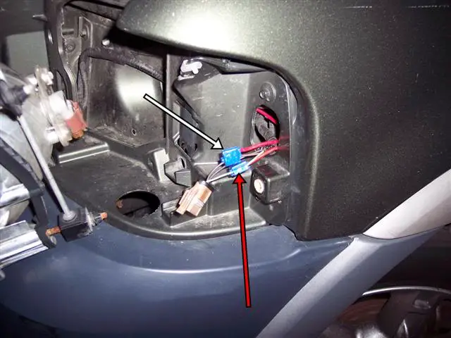

I tapped the parking lights at the driver's side parking light itself, not a big deal since you have to route wires in that area anyway. The picture is from my how to for installing signal mirrors, the link is in my signature. There is some good info there for routing the wires.
Peel back and remove a portion of the plastic wrap - The red arrow indicates the quick splice connector connected to the Green w/White Stripe wire for the signal mirror - The white arrow indicates the quick splice connector connected to the Brown wire for my fog light relay.

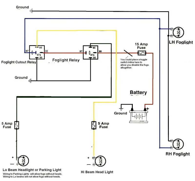

When wired as above, the aux lights can only come on when the parking lights & the switch are on. When the parking lights are on you can shut off the aux lights with the switch. I will be re-wiring the fogs so they automatically shut off when the high beams are on. I will be using this diagram as a guide. I apologize for the size of the diagram but I wanted you to be able to read it:
