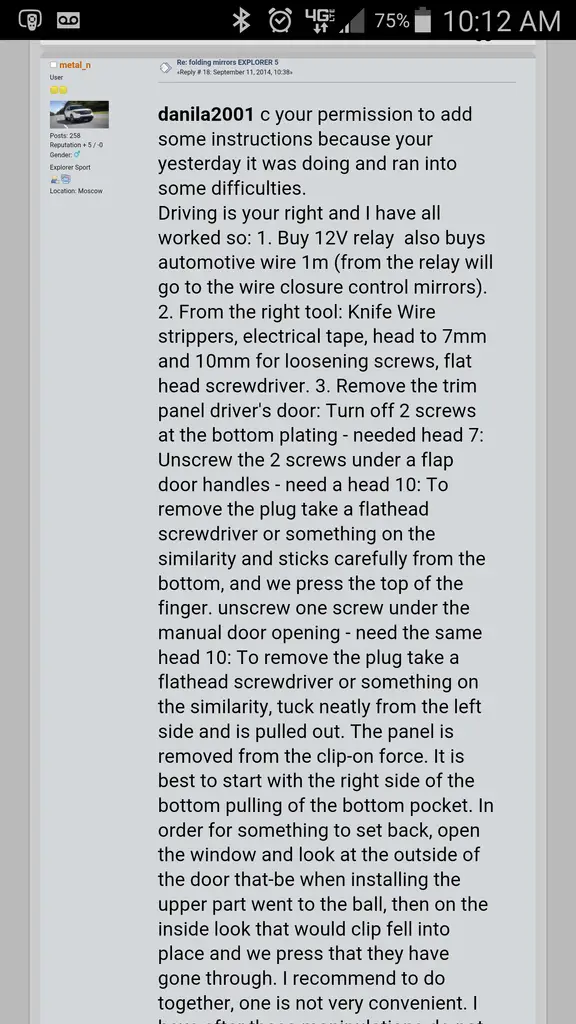

At least these guy's have a solution! Auto-fold should be expected by default correct? I did not know that it was manually; I only found out when I bought my "15... I could not believe that auto-fault is not standard in our Explorer! I think with Ford you better check anything, and assume nothing!
All you do is hit the translate button on your browser and it translates it to english...isn't technology wonder full????...sorry I should have stated that you need to translate it...I thought it was a given.
