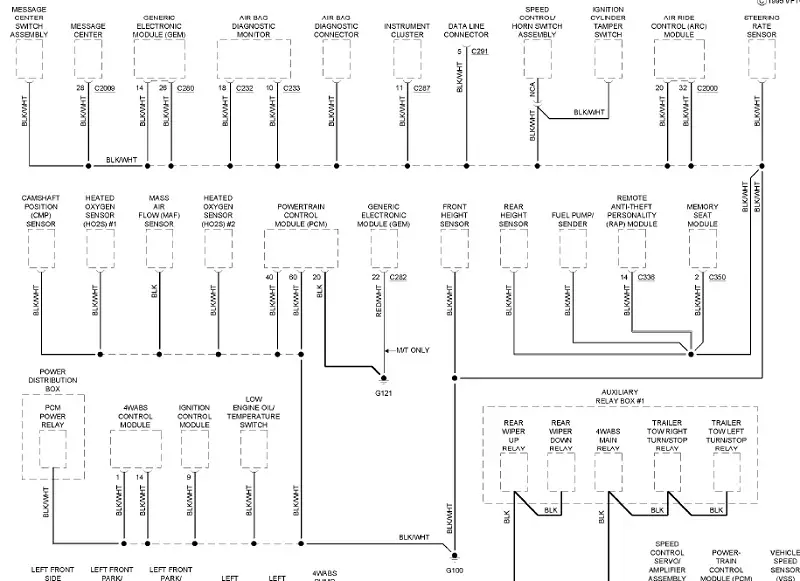

ignition related grounds
The wiring diagrams I have access to don't identify the ground location for the ignition coil or the radio noise capacitor.
Normally the secondary of the ignition coil is grounded thru the bolts that mount the coil. The primary is grounded by the circuits in the ignition control module. The ground end of the radio noise capacitor should have a wire that is either connected to a firewall stud or a stud on the engine. The ground connections can become corroded after 20 years so it might be a good idea to clean them by scraping.
The PCM power relay is grounded by G100 which is a common ground for numerous devices.
I don't understand where you measured the 0.3 volt drop but that is not unreasonable for 10 feet of wire and connections.
What are your ignition related symptoms?

Well, she'll fire right up as if nothing is wrong. For the most part she runs, but she keeps blowing fuse 19. Then its crank but no fire. ( no power to the coils, duh). After it pops 19, sometimes I can simply replace it, other times it will immediately blow the fuse again and I have to let it sit. I've only owned the explorer for about a week and a half, so I don't have a complete history for the vehicle.

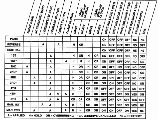

my 98 Explorer is getting a code p1761 powertrain module. I think it is because 2nd and 5th gear band is broken in the transmission. Is there a way to get rid of this code so it will pass emissions without fixing the transmission?

P1761 Shift Solenoid No. 3 Performance
It could be a bad solenoid as well as the front band.
You'll probably have to fix the problem. If you just clear the code it will probably come back before you get to the inspection station.

A shop dropped the pan and determined it is a broken band. No 2nd or 5th gear. I would really like to be able to find a work around to get through emissions inspection.
