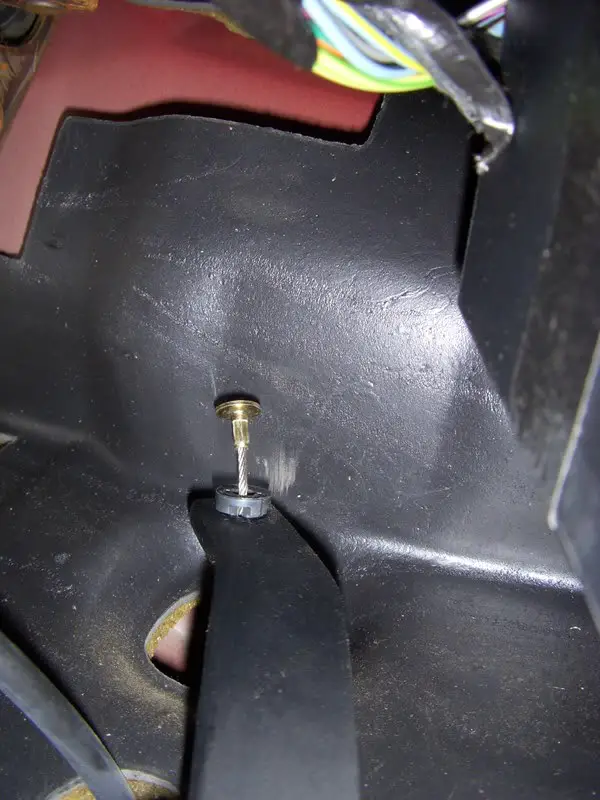

First thing to do, pull gas pedal up twords the seat looking at the top of the pedal where the cable is attached to see how much slack is there you can measure it so you can figure how much tubing you will need.
(l;ost photos)

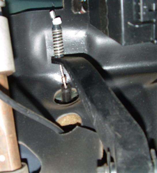

after this has been determined, find what ever it is that you want to use to keep the cable in that position. Me I used a drip line hose it has a small diameter and is pretty strong
Cut the hose to needed length w/ either scissors or wire snippers what ever you have that is closest or want to use, then take the razor blade and cut one side of the tube so you can put it over the cable like this:
Then take a wide zip tie or ties and place over the tubing, pull tight and snip off the excess.
sorry that pic is blurry but you can sorta see what im talking about. Then after all this is completed take truck for a test drive. Maybe someone could post where the kick down cable is so this thread could help everyone. After doing this mod to my truck I now have a better throttle response which makes me happy espesically since this mod cost me NOTHING! Hope this helps.
