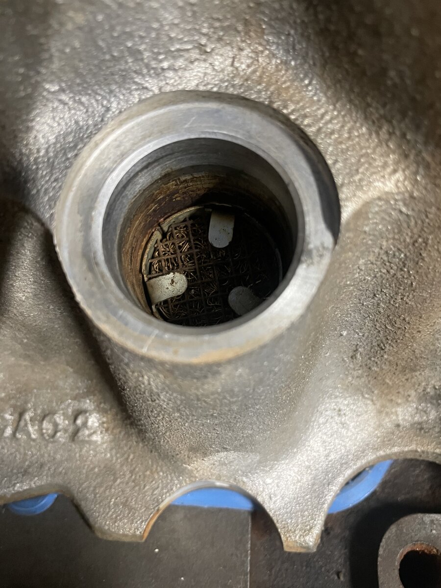

Just happen to be standing next to 5.0 with the lower intake exposed
This is a 98 engine it has the screen

That's a very good picture of it, the screen is just to reduce the amount of oil that is sucked out of the lifter valley. It's to try to catch the oil coming from the crankcase, and have it collect on it, to drain back down.
It's a good idea and that's what is needed by people with turbo's and running catch cans to catch oil out of the PCV system. Something that catches the oil but returns it to the engine, is the ideal, a catch can collects it outside the engine, so the oil is lost from the engine.

We didn't see this inside of my intake. Is there a part number for this screen on a 2000 5.0? Curious as to why it was not there?
That screen is about the same depth as the diameter, it just drops down into that hole. All roller 302's and 351's probably came with it. I recall it on my 91 302 HO I rebuilt, and I've seen it in other 302 intakes.
