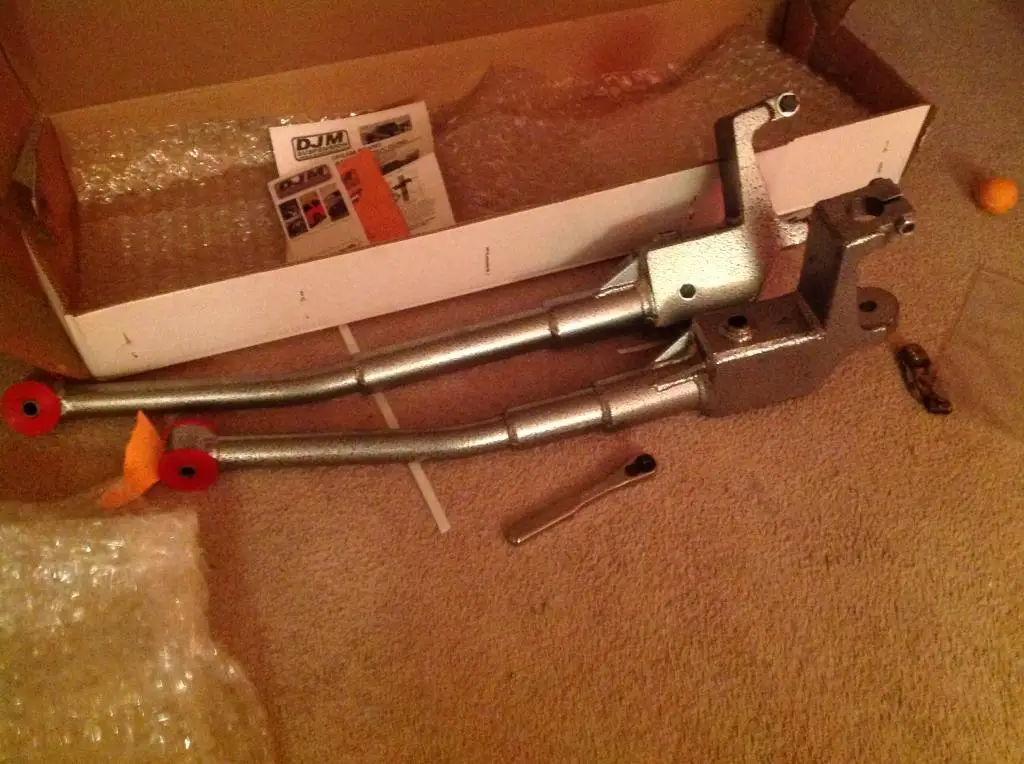

They've been delivered. I talked with the landlord and told her she could let the UPS guy in to deliver them, and called the fiance as soon as I new she would be home just to make sure they were delivered. They're so beautiful!
