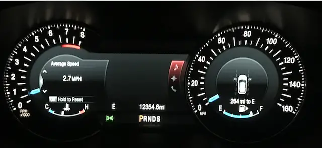

I found a code to enable an average speed display, on the Platinum it appears under Fuel Economy > Average Speed. On non-Platinum displays, it should also show average RPM. Please let me know if you try it.
720-01-01 xxxx x6xx xxxx (6 or E)
