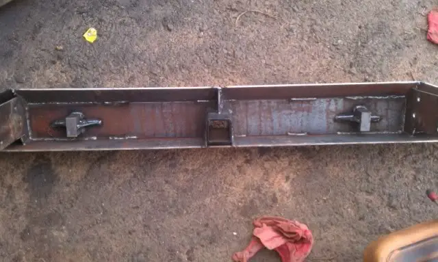

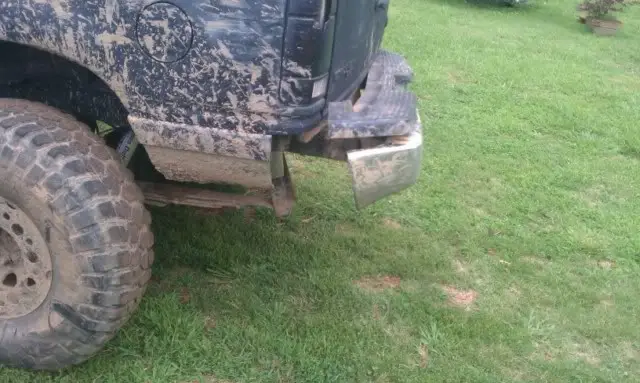

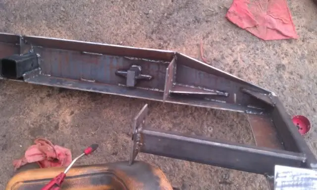

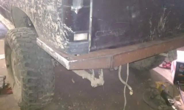

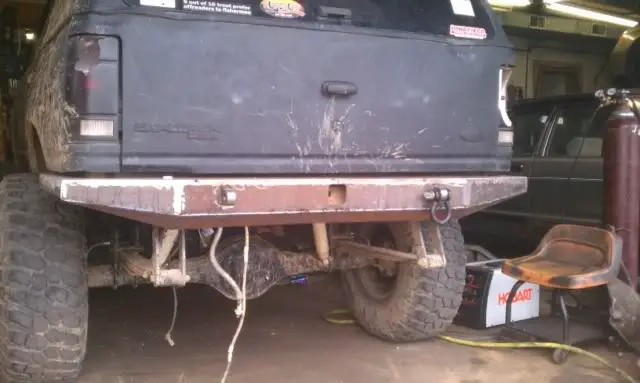

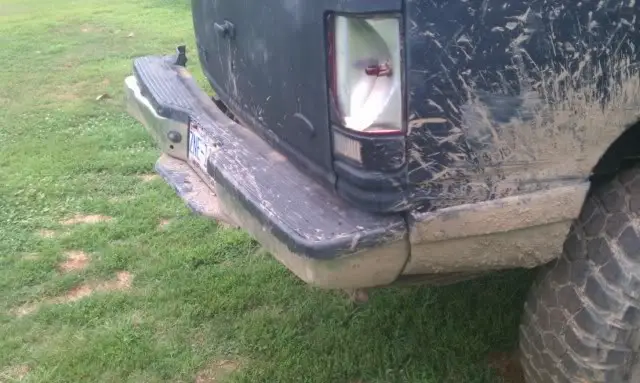

About ripped the stock bumper off.

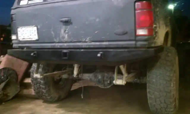

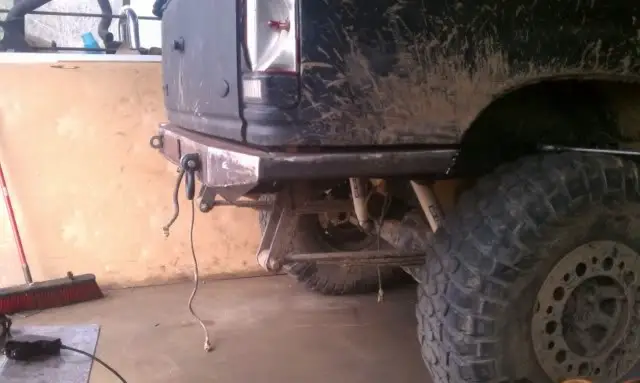

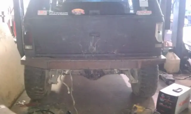

So I said ill try making one.
Gussets on the inside.

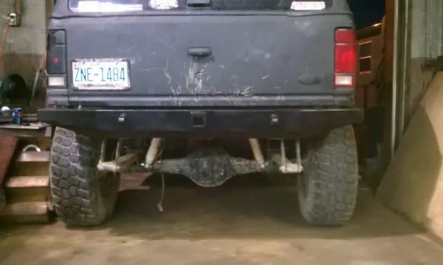

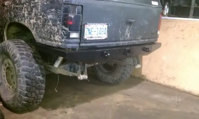

Got it painted and put on. Its head one with 12 half inch bolts so it shouldnt be going anywhere. Its all 3/16 plate I cut out with a angle grinder. lol

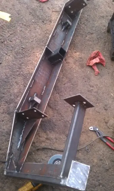

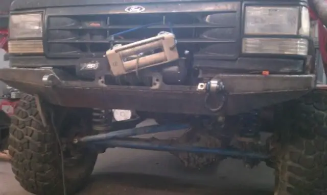

So then needed one for the front so started on one for it. Still havent finished it yet so no finished pics yet.

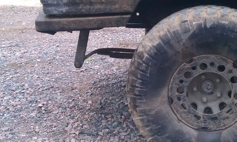

Nothing serious. Just another driveshaft. Thats 3 or 4 now. Going to have to do something about that. lol

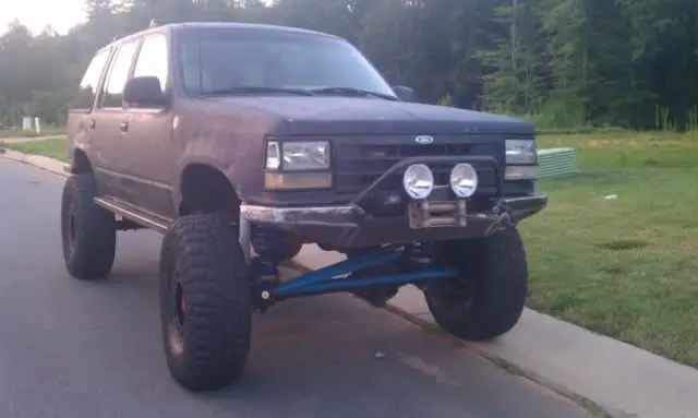

Did a little more work on the bumper Saturday. Almost finished with it. Got a little more grinding and welding to do and wire up the lights. Also took the roof rack off.

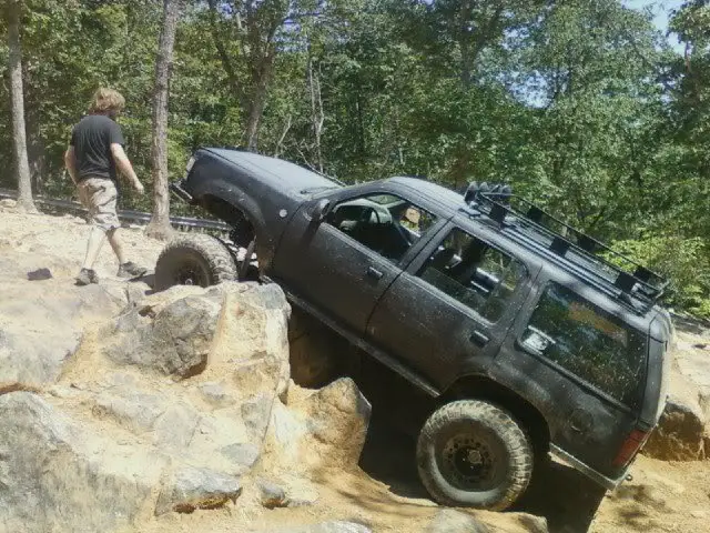

My first attempt at on the hard line at kodak rock didnt turn out to well. Got on top of it and it started running out of gas. Acted like it had a carb on it. lol Was only getting air to the fuel rail so I dont know what the deal was. It was fine all day the next day though.
Second attempt crawled right up it since it stayed running. lol
