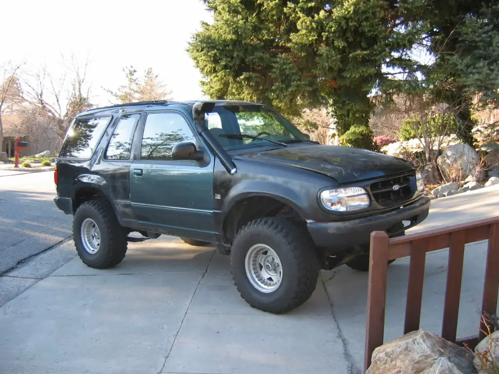

now here are a few recent pics :D (my sisters bf is in the driver seat)
and sorry for the big pics! :)

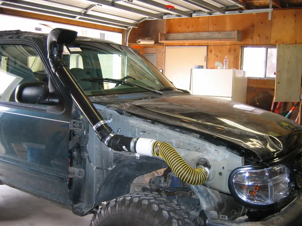

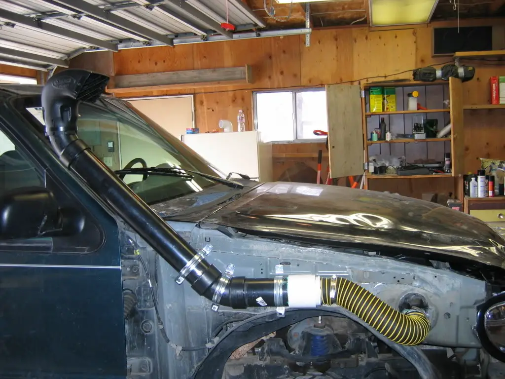

i am also installing the snorkel this weekend, here are a few teaser pics. im using an arb top, and building the rest. i got the larger arb top, so its the 3"
this is inside the airbox
here is the outside, and as you can see, i cut away the support that was on the inside under the fender
and here is my dad holding the snorkel pipe

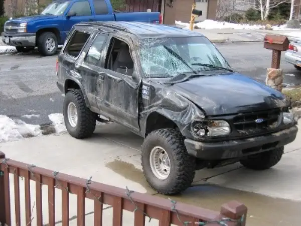

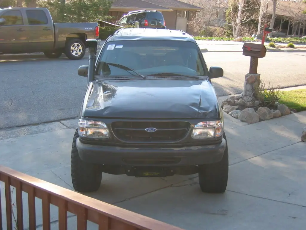

here is a before pic, after the rollover/and after for comparrison
Nice restore (so far...). Glad you didn't get rid of it before :thumbsup:
oh i tried.. but no one wanted it hahaha! it sat for over 3 years in **** condition, and soon it will be ready to rock! and thanks bro

ok, snorkel is on.. i will be cutting the fenders in just a little while to make them fit, then they are getting painted.

I love the snorkel install as well, the way the pipe run up the pillar and isn't pulled off from it. That's how I want to do mine. Is that all 3'' PVC?

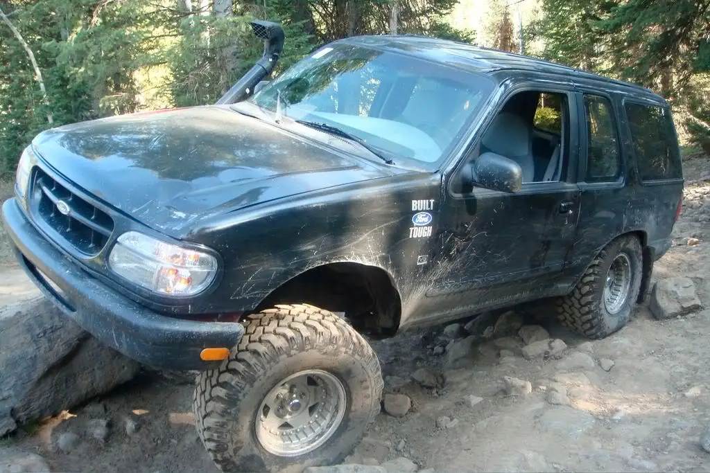

hey jason :) yea, it will be a trail/fun rig. i will get it registered so i can drive it on the road though. i used to have an 03 x, but i traded it in and bought an audi S4. here is a pic from sunday out at the salt flats.. there was about 2" of water on the flats
yea, the snorkel is 3" pvc. if i could do it over i would have gone with the 2 1/2" top. i had to cut a rather large hole out of the fender to get the pipe to come through, because it was just too big/thick.

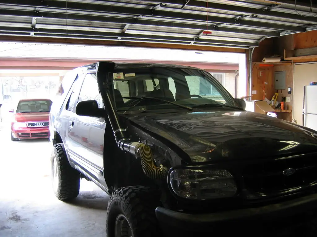

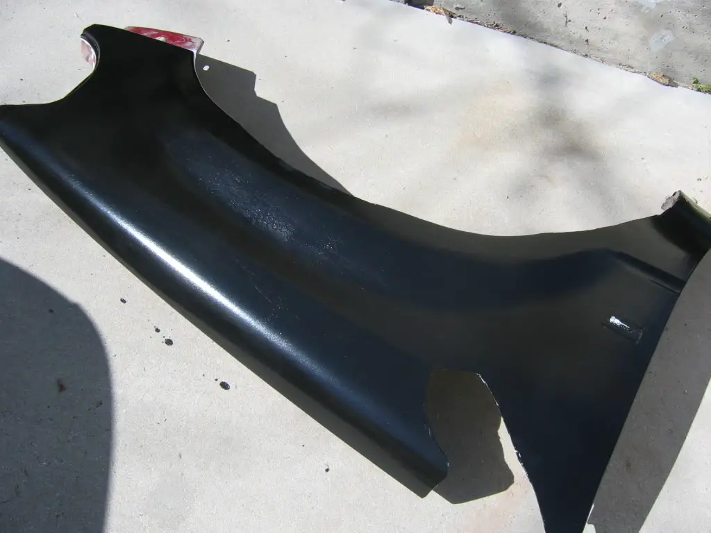

ok, painted and re installed the fenders. will probably do the door next weekend and any other misc areas(hood/roof) in certain spots.
need some more $$ to keep this project going. i drove it all day today, it was fun, also gave it a bath :D
looks awesome is ur sport a V8 cause i see the V8 emblem
na, those fenders are just off of a v8 explorer. mine has the 4.0 ohv 6

looks good! Whats the yellow/black flex pipe you used for the snorkel?

its called LT hose/ducting. its rubber with metal wire inside. its industrial strength so its pretty durable/strong. i had to go to a specialty store to get it. only one place in salt lake city sells it.. kinda dumb. also it was like 6$ a foot, and minimum 2 foot buy.

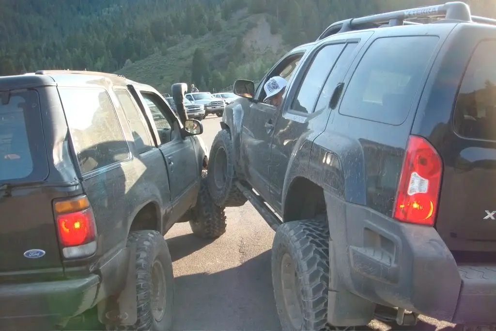

so i went wheelin again with my buddy in his xterra. the xterra is on 33's and has a 2" lift. it has atleast 2" more ground clearance than the explorer. damn explorer...
