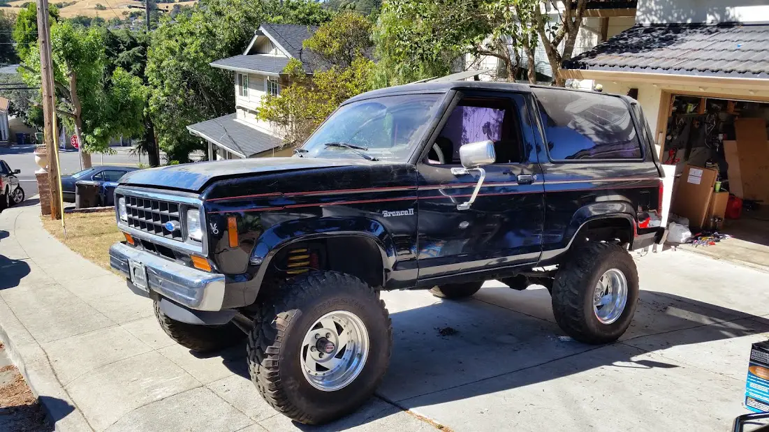

Hi all,
I am new to this forum and to the bronco as a whole. An old friend is giving me his 84 Bronco II with 150,xxx miles. It was in running condition when he parked it in a warehouse and covered it. 15+ years later he had it towed to his house and now wants it gone... Thats where I come in, I am heading over there this weekend to try and start it to get it home (15 mile drive or so). Towing is my last option if I can't get it started.
What should I do before I crank the key to start this sleeping beast.
- Drain the gas (now varnish) flush the lines, new gas.
- pull the plugs and squirt some oil in the cylinders manually turn the motor make sure its not seized
- New Battery
- check all hoses
- oil change and coolant flush
- carb cleaner everywhere in the carb(until I can replace-options- or rebuild it)
- START IT?
I would like to make it a daily-ish and trail rig.
any other help or input would be appreciated. Thanks in advance!
here is a pic of it.

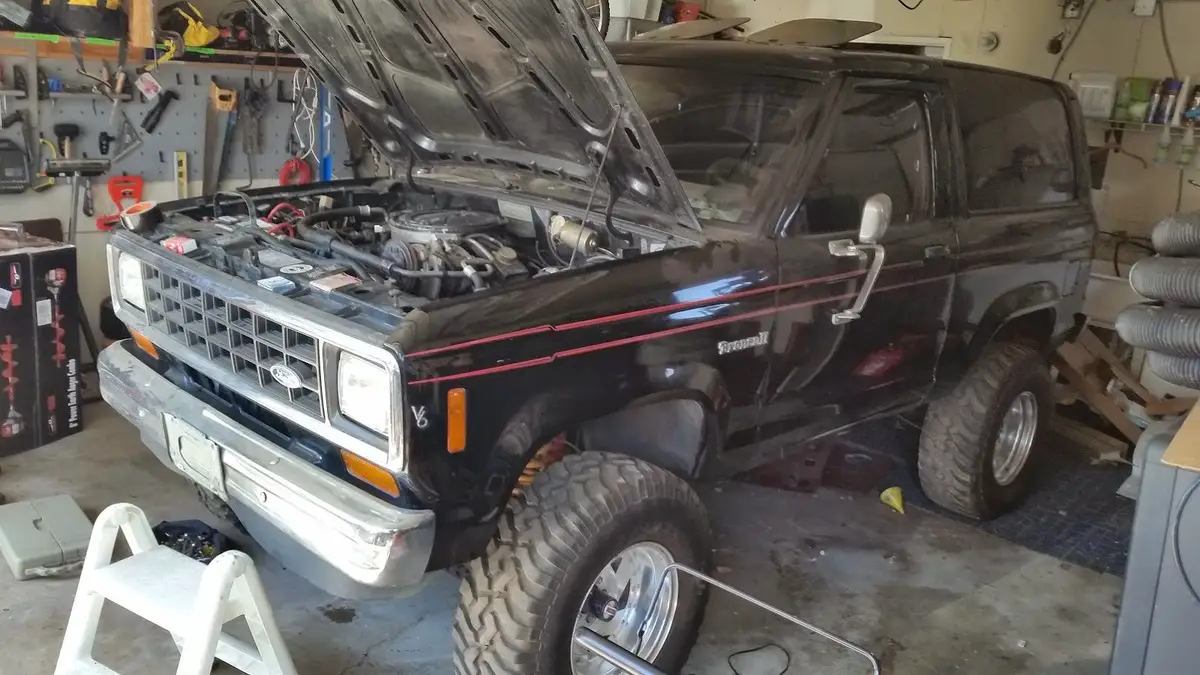

Update, I went down to the house its stored at and played around with it. (sorry for the length of this read. (a couple Pics at the bottom)
TL;DR - engine runs off gravity feeding gas, clogged fuel lines and bad fuel pump, needs radiator hoses and thermostat, interior is missing dash/stereo and door panels, will be working on it more next month to get it drivable and get it home.
I spun the motor by hand and it spun surprisingly easy, felt compression on all six while spinning the crank with the socket wrench. Siphoned the old gas as much as I could and dumped a can of seafoam and a gallon-ish of fresh gas in the tank. Coolant was mostly evaporated so I topped it off temporarily. Removed the fuel line off the carb and attached a hose dropping into a bucket to see if the lines would pump any gas out/ push out any crap inside the lines. Sprayed all accessible holes on the carb with carb cleaner and went to crank it get some fuel out. I put the battery from my truck into and turned the key......... nothing! got lights on the dash and buzzer going nuts but no starter cranking.
So I figured the starter needed a nice whack with a hammer. Crawling under with a hammer to smack it around and noticed there was NO STARTER!! ugh. Found the starter in the "trunk" along with the dash and door panels :/ Found no bolts for the starter though. I quickly grabbed some bolts from the hardware store and only the top would thread in. I need to drill the bottom hole through and put a nut on it next time I go out.
Got back in the car and cranked the motor to pump some fuel into my bucket. after about 5 seconds of cranking THE ENGINE STARTED!!! with no fuel line attached, burnt off the carb cleaner I sprayed in there and it died. Roughly 10 seconds of running. SWEET the engine runs, no misfires or knock whatsoever :D
No fuel came out of the lines so I assume I need to replace the mechanical fuel pump which is a PITA to get the bolts out, saving that for the next visit. If it doesn't pump with the new one in I will drop the tank and flush the lines.
I did gravity feed the carb with a gatorade bottle and hose fired it up for about 30 seconds holding the RPMs at around 1200 or so. Runs smooth but noticed a leak in the radiator hose.
Next time out I will change the oil, address the fuel issues (maybe drop the tank), radiator hoses and thermostat, flush out the cooling system, and bleed the brakes/clutch and hopefully it will run under its own power. Oh and the shifter has a LOT of play so I need to swap the stick out for a better one, I think its a TK5. I wont be able to work on it until next month due to a business trip but I will update as I get moving on it more.

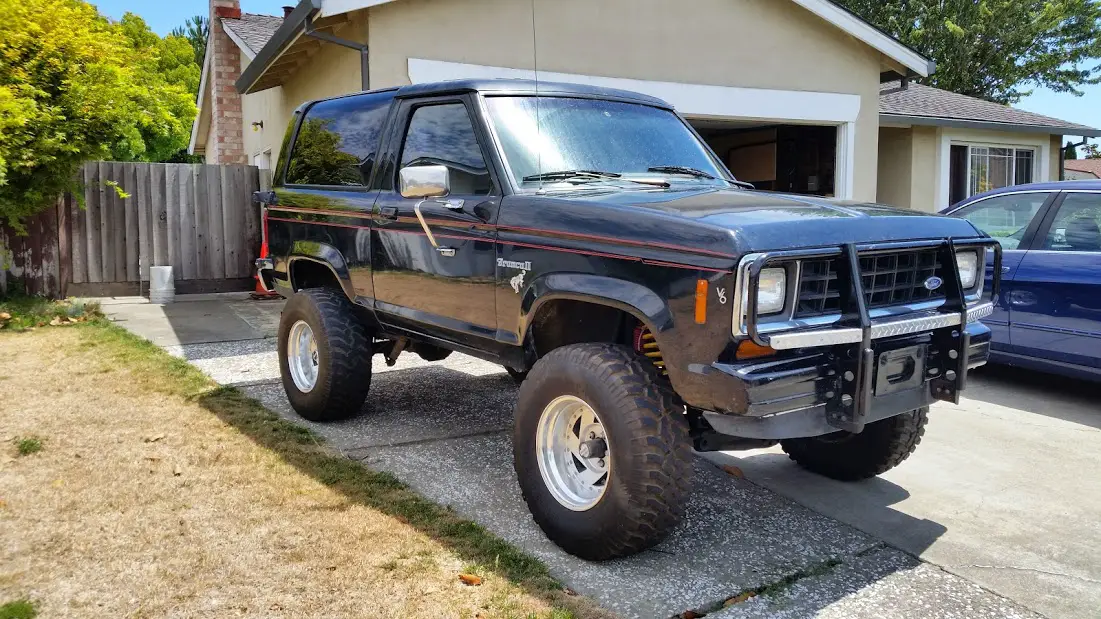

Alright here is a short update.
My last trip out was successful. I dropped the tank, cleaned it out and installed a new sending unit. Changed the oil and flushed the cooling system. Got a sweet grill guard for it off a ranger at the bone yard. Got the tank back in and did a quick run over the entire truck.
Needs a master cylinder and a little TLC but overall it runs great! Next up are some new rubbers and registration. Then interior work will begin.
It was stored away in 1992. Drove it under its own power for the first time in 22 years.
PICS!
Clogged sending unit replaced.
Brush guard installed! Looks sweet!
Needs a bath.
